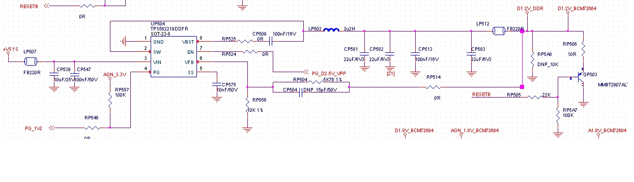

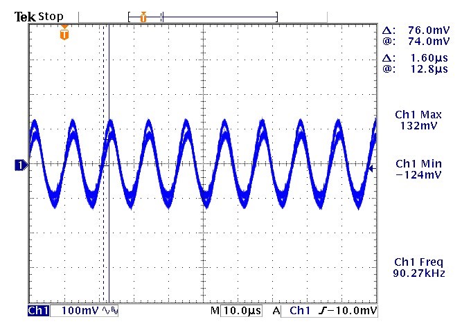

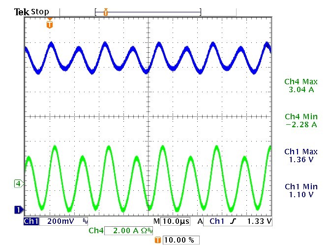

TPS562219 output current oscillation.
What is cause the current oscillation? please help command to resolve this issue.
Vin=12V; Vout=1.2V ;Io=0.2A
Current (Green:current oscillation)
Output ripple

Hi Hermes,
Could I know how and where did you measure the current? How is it operating for the Reset circuit at output?
Is the LP512 a bead? If yes, remove it or remove it behind the line which connect Vout to the RP514 .
Besides, pls upload your layout
