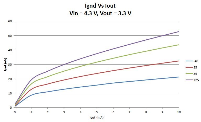

Can we have any data of the ground pin current at a few mA like Fig.10 in the datasheet for TPS70633 ?
It's a very important information due to battery application.
