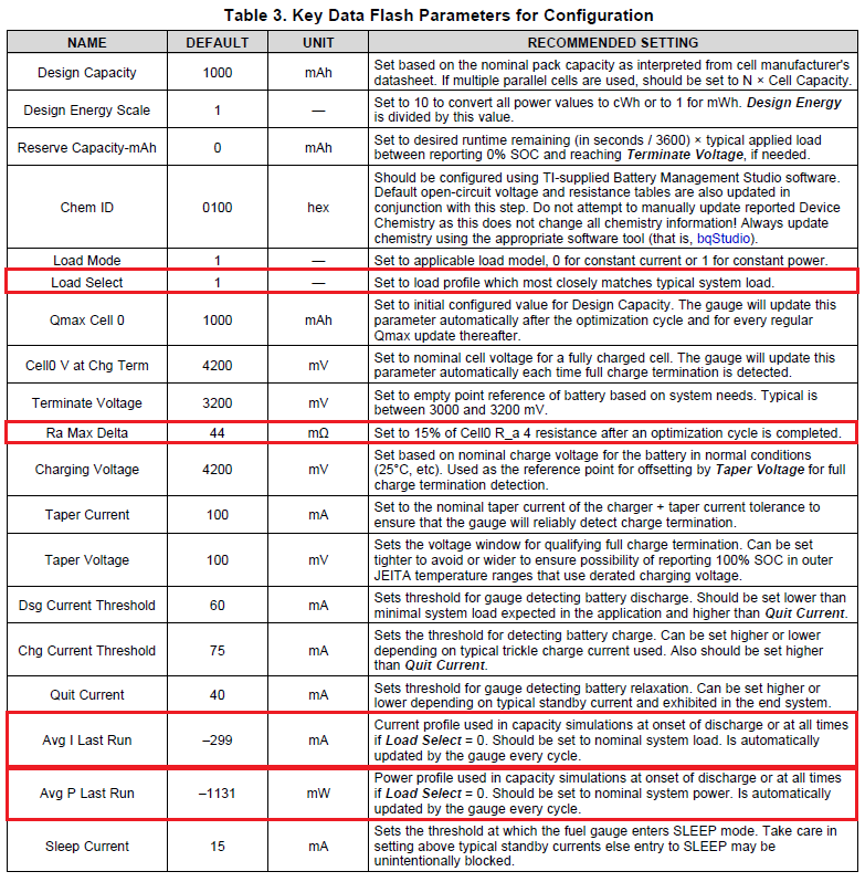

Hi Team,
The datasheet shows the following in page 20 however red part parameters can't be found in "bq27320 technical reference manual".
- bq27320 technical reference manual
http://www.tij.co.jp/jp/lit/ug/sluube6/sluube6.pdf
How should we consider above?
