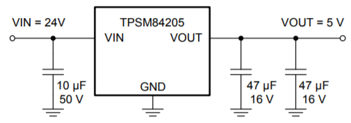

Hello, my name is Diego, I am a 16 year old maker from Guatemala, and I really need some help. I am trying to find a way to step down the voltage and current from my 12v 60A lithium ion battery pack that I built to 5V 1A. I found the LMR23610 but it doesn't say what the input current is on any of the paperwork, can somebody help me please?

  • Hey Diego,
    Thanks for stopping by E2E!
    I wanted to recommend our TPSM84205 module. This is a module that is pretty much fully assembled. It has 3 pins, VIN, VOUT, Ground.
    • You give VIN a voltage between 7V and 28V.
    • It will automatically set VOUT = 5V.
    • You can draw up to 1.5A OUT (so your 1A out is fine)
    So at your specs, 12VIN, 5VOUT, 1AOUT, the part will automatically pull about 0.5A from your battery.
    The schematic is below. We recommend putting some capacitors on VIN and VOUT to smooth the voltage, but the rest is on the TPSM84205 board already.
    Hopefully this helps. Have fun!
