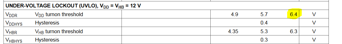

What's the VDD operating range of UCC27212?
It's shown as 5-17V at the "Features" section but 7-17V at the "Recommended Operaing Range" Section.
Please advise.
Thank you!
Roy Hsu
  • Hi Roy,
    Thanks for your question, and sorry about this confusion. I work as an applications engineer with the UCC27212 and hope to answer your question.
    The UVLO threshold can help clear this up. The screenshot below shows that the UVLO max rising threshold is 6.4V making 7-17V the correct recommended operating range.
    I will make an action to rectify this error to correct this in the datasheet. Please let me know if you come across any more questions.
