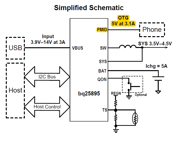

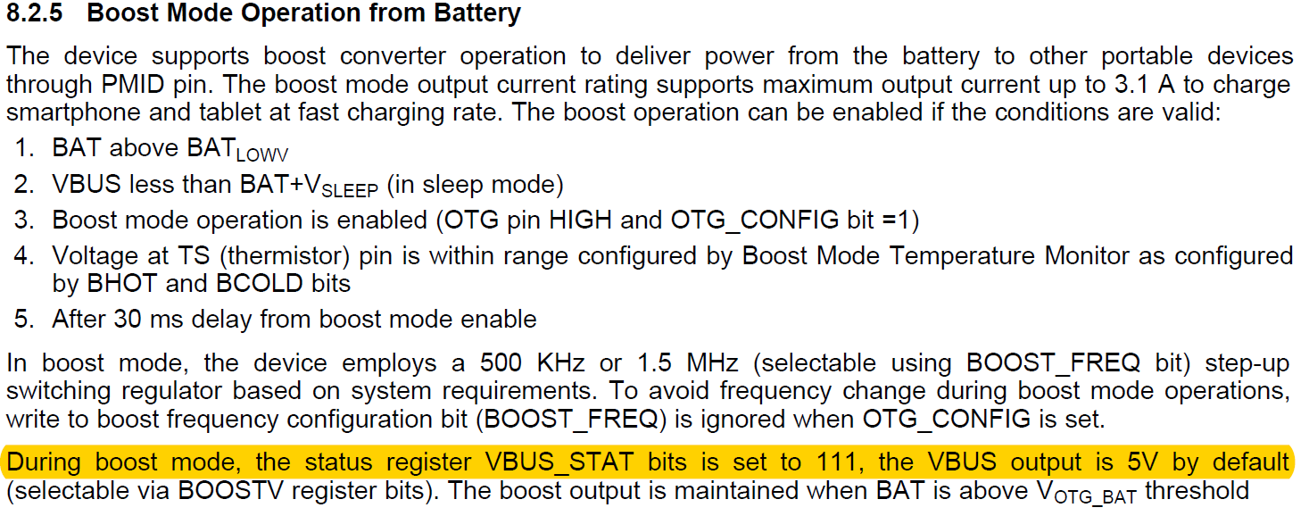

Hellow,
At BQ25895 datasheet page 1, it's describes OTG mode output is PMID pin, but aonther describe OTG mode output is VBUS at page 20. Which one is right?
