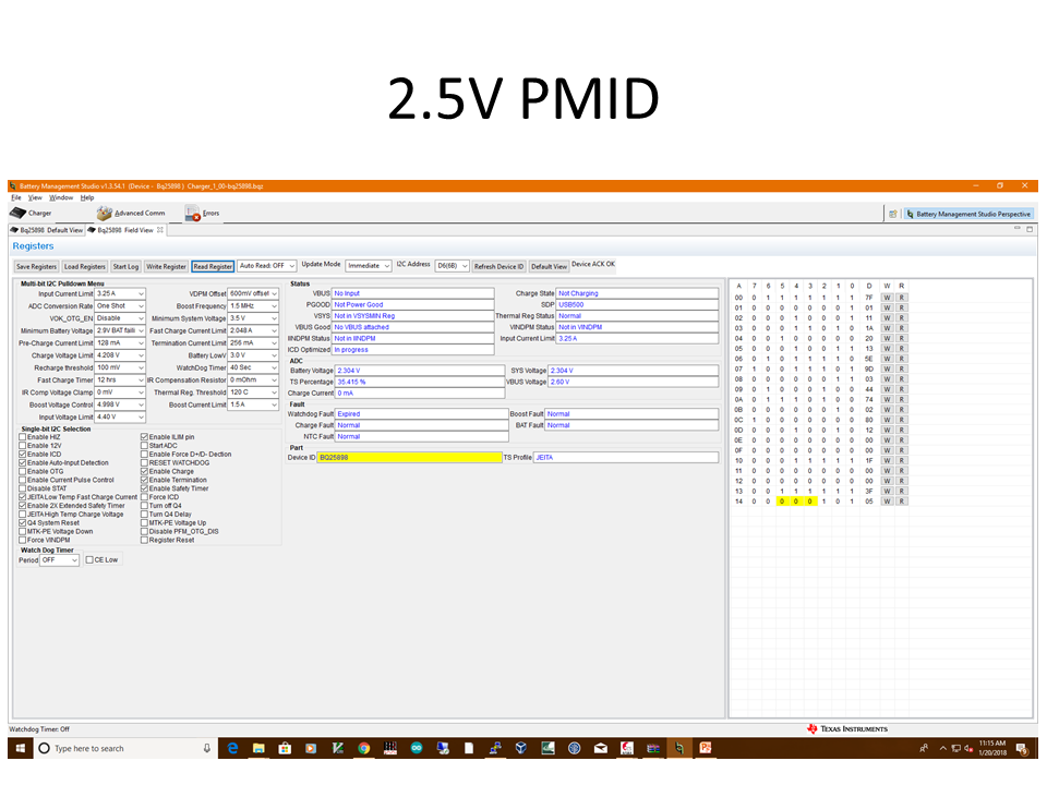

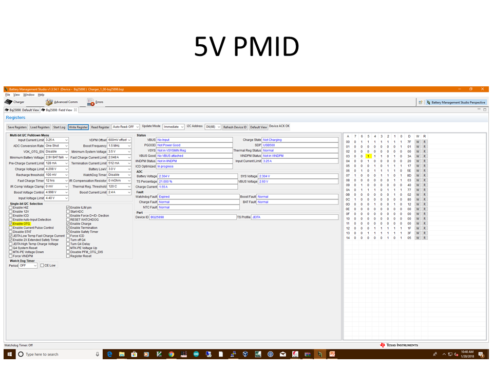

1. When I check Enable OTG in "battery management studio" tool, I get 5V but as soon as I connect a load  (10E, 20W resistor) to this pin, it drops to 2.5V giving only 250mA current.
2. When I remove load, this PMID pin stays at 3.9V (similar voltage to Battery voltage) unless I unchecked and checked Enable OTG again.
Here is the screenshot of my setting
Please suggest if there is any setting that I am not doing properly.
  • At which pin did you place the load?
    Please read the GUI after you select "ENABLE OTG" and get 5V OTG output, check if there's any fault in the registers. Then apply the OTG load, read the GUI again when OTG output drops to 2.5V, check if there's any fault in the registers.
    Thanks!

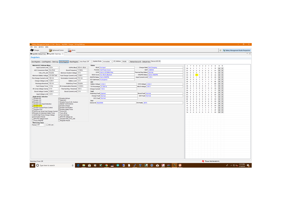

  • Hi Ning Tang,
    I am connecting load to PMID pin (J2 on BQ25898EVM-730 board).
    Load is 10E, 20W laod.
    I checked the GUI for registers values. If I don't read the register, PMID voltage remains 5V after removing the load, but if I read register, the voltage reaches to only the battery voltage after load removal.
    here are the snaps of registers for reference.
    I also saw that Enable OTG gets unchecked every time I read registers, if I don;t read register, it remains checked.
    Looking forward to your reply.

  • 1) For your GUI setup, it only shows the register values when you click "read register". The register values will not be automatically updated with the current register values. For the 5V PMID GUI picture, VBUS status shows "No Input", but at the time the device should be in OTG mode, so please click "read register" again to refresh the register values after selecting "Enable OTG" and observe 5V at PMID. At this time, VBUS status should be read as "OTG" (REG0B[7:5]=111).
    2) After connecting a load to PMID, click "read register" again. Check if VBUS status is "OTG" or not and if there are any faults.
    Please note that REG0C is a fault register. It keeps all the fault information from last read until the host issues a new read. For example, if Charge Safety Timer Expiration fault occurs but recovers later, the fault register REG0C reports the fault when it is read the first time, but returns to normal when it is read the second time. In order to get the fault information at present, the host has to read REG0C for the second time...
    3) It is possible that connecting the PMID load introduces some overshoots and cause Boost Fault. Once that happens, the device will exit the OTG mode automatically.
    4) Are you evaluating bq25898 or bq25898C? bq25898C does not support OTG.
    Thanks!
