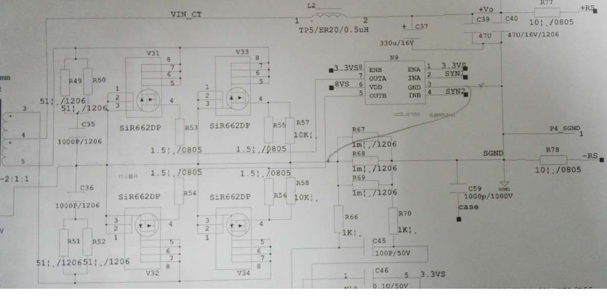

    the UCC27524 circuit diagram on the map is to simulate your TI's UCD3138-based full-bridge hard-switching development board circuit to design. The UCC27524 driver is labeled N9 to drive the secondary synchronous rectifiers V31, V32, V33, and V34.

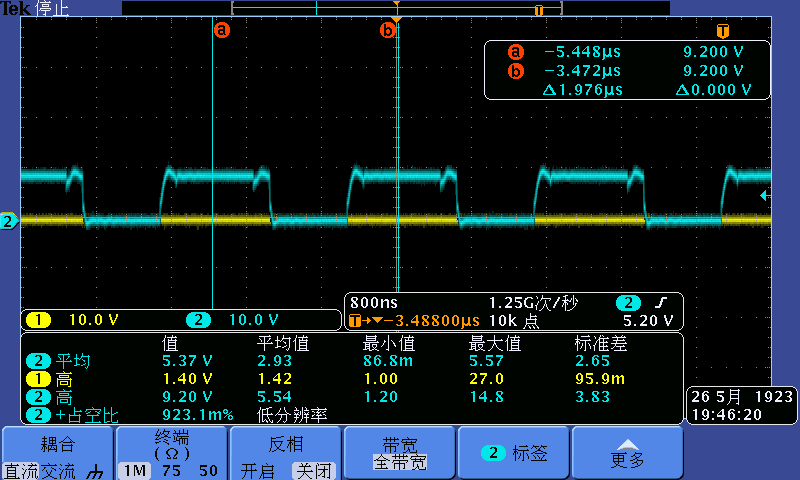

  • Normal circuit board OUTB waveform
  • The figure above is the waveform of OUTB on the normal circuit board.
    The slight distortion of the waveform is the moment of the primary drive PWM conversion.

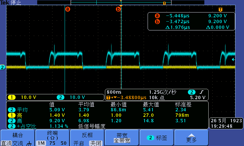

  • Abnormal circuit board OUTB waveform
  • The figure above shows the waveform of OUTB on the abnormal circuit board.
    OUTB will have a spike of about 15V while the supply voltage is only 10V.

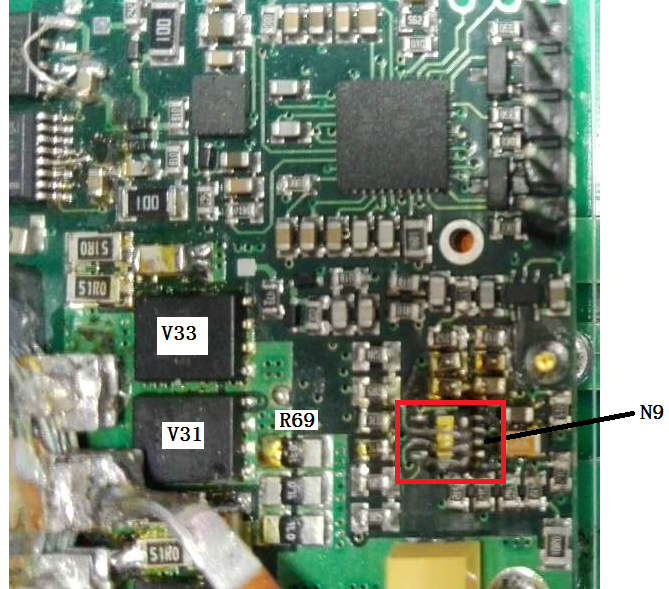

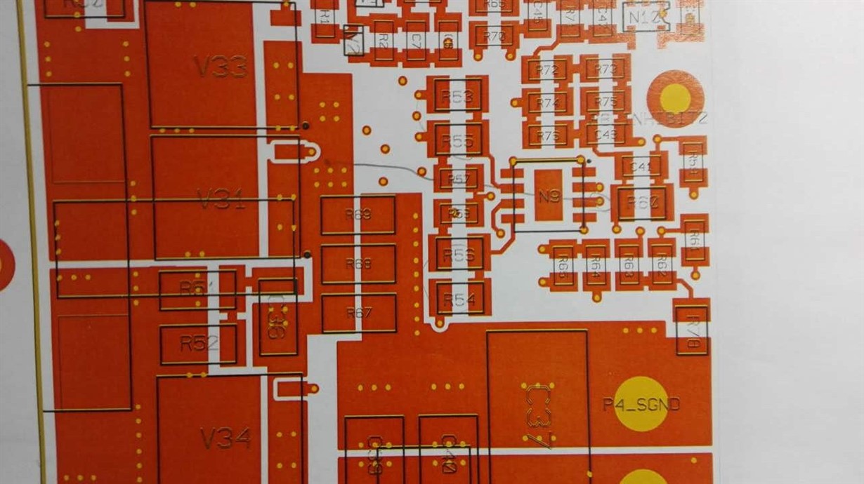

  • UCC27524 circuit layout
  • The figure above shows the layout of UCC27524.
    The 3.3VPWM driving signal from UCD3138 enters from the right side of N9 and the left side of N9 outputs 10V PWM to drive secondary synchronous rectifiers V31, V32, V33 and V34.
    The order of package pins 1 through 8 of this layout N9 is wrong.
  • UCC27524 actual assembly diagram, UCC27524 is erected welding. Its 5,6,7 feet through the wire fly to the pad.

    Thanks for your update and much appreciated info! I have understood your issue. It appears that the EVM user guide http://www.ti.com/lit/ug/sluua95/sluua95.pdf figure 32 shows the switching waveform of the powerstage. The spikes like you said are due to primary side. Since this spike lines up with the master leg switch node (TP23) then as the master HS fet of the primary full bridge turns on the switch node experiences a ringing due to the parasitic inductance and LS fet parasitic capacitance on this node forming a LC resonance. The resonance spike will become magnetically induced through the core and coupled to the transformer secondary and manifests itself as a spike on OUTA in the EVM userguide (however I understand its OUTB in your case...maybe they are just swapped...to confirm your scopeshot, the SR FET is ON when the spike occurs is the fet being damaged). You can read about this ringing phenomenon in this AN - http://www.ti.com/lit/an/slyt465/slyt465.pdf. You have a few options to reduce this ringing spike. The following 2 will aim to reduce the magnitude of the ring: Add a gate resistor to slow down the HS fet and therefore the high slew rate on SW. Add Rboot for a similar effect. The 3rd method is for dampening the frequency of the ringing with a snubber with a lesser affect on magnitude.
    Anyhow, Let me reachout to the controller team and get their input as well. I will update you with their reply tomorrow.
  • In the mean time i will take a closer look at your layout, also I believe the quick fix would be to slap a zener on it and clamp OUTB to ~10V. And If possible, I would like to see a scopeshot of the master leg SWnode to see if this is really where the spike is coming from.
  • Hi zoujiangyilang,
    Update: still awaiting controller team's reply. From what I can see on this top layer, layout is not bad. Are you using the blue wire on both good and bad boards? do you think this issue could this issue be due to soldering?
