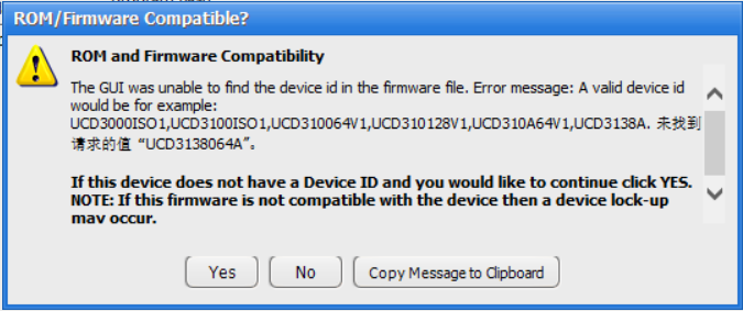

I use sluc609 code ( EVM : UCD3138OL64EVM-31 Rev.A ) , but The GUI was unable to find the device id in the firmware file .
Could you tell me the reason and how to do for it ?

I have downloaded the sluc609 from ti.com.
There is a minor issue in the project that prevents generation of .x0 firmware image file.
Under Project properties, Build -> Steps:
Please remove the outer parentheses in the "Post-build steps", click OK and rebuild for UCD3138064A.
The new .x0 file should be under the UCD3138064A folder only.
Please check the date of the .x0 file and make sure that it is not an older file.
Hope this one downloaded fine for you. I have tested this and it works fine for me.
