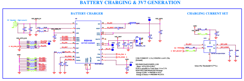

In our design we connect the TS pin with an equal sized resistor divider from DRV to TS to GND. So I would like to know how the TS pin will be functioning in this combination of resistors. Will there be any role of Vwarm and Vcold in this setup. Is there any Temperature control being done in the charger if the Battery does not have a NTC pin.

    In regards to your comment about the TS pin resistor divider, two equal-sized resistors should be fine. That will be you a 50%VDRV voltage at TS, results in a TNORMAL temperature. You may also disable the TS functionality by pulling TS to DRV directly. This pushes the TS voltage to above 70%DRV.
    This is all if you plan on not using an NTC thermistor to monitor the battery temperature.

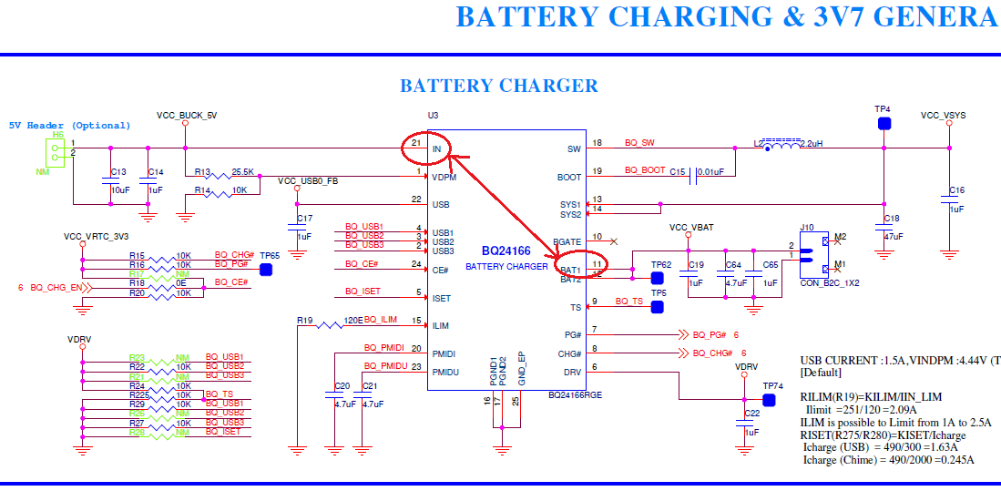

    Sorry for the delayed response. When we discussed with the certification Team. They have provided us the following inputs. Please find the below attached Image from the Certification team. They are testing by physically shorting the Pin-22 & Pin-11. and Pin-21& Pin-11. At this time the voltage at VUSB and VIN will be 5V simultaneously. This is the method of Testing by them. Can you suggest how we can modify the circuit accordingly to meet their requirement. Below is their mail to us.
    "1. A higher charging voltage than the maximum specified charging voltage was occurred after the introduction of a single fault condition with U3 pin 22-11 shorted under 5Vdc supply condition; Measured charging voltage: 4.98Vdc (Maximum specified charging voltage: 4.20Vdc declared by battery supplier)
    Below is standard requirements:
    2. A higher charging voltage than the maximum specified charging voltage was occurred after the introduction of a single fault condition with U3 pin 21-11 shorted under 24Vac supply condition; Measured charging voltage: 5.12Vdc (Maximum specified charging voltage: 4.20Vdc declared by battery supplier)
    The battery supplier replied that the maximum certification charging voltage of the battery is 4.20V, and cannot be increased or changed the battery charging voltage any more, so need client to modify the product charging circuit and reduced the charging voltage below 4.2Vdc under all operating conditions (normal or abnormal)."
  • Johny,
    The simplest solution is to add a ~4.3V Zener clamping diode and series current limit resistor at BAT to prevent overvoltage.

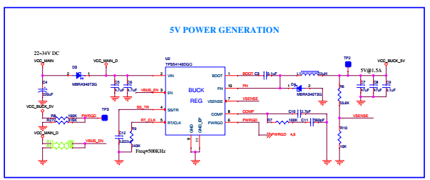

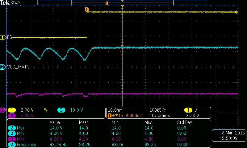

    We were also facing another issue in the BQ24166 IC. Our device is working in full time battery mode. We are using AC input supply for charging the Battery. The AC supply is rectified using bridge rectifier and the rectified input is given to the TPS54140 Buck regulator. And a 5V output is givrn to the BQ24166. The issue what happens is when we try giving 9VAC. When given to 16VAC it does not have any issue. Also when we give this to constant 7V DC at rectifier side there is no issue. The charger PG# pin is toggling at regular interval of time. The Graph is attached along with.  Some times the supply gets dipped. And the source is not able to give constant supply. Can you please suggest the possible reason for this.Is there anything we can do on the TPS54140 side or the BQ24166 side to avoid this. Attaching the Scheme.
    The graphs of the power lines. The graph shows the PG line pulling up. The Pink line is the 5V buck output and the blue line is the rectified AC input.
  • Is it possible that the charger is pulling more current than the buck can supply? The buck is set for 1.5A but the ILIM for the charger is 2.09A. Do you have the capability to measure the current going into/out of the charger with a current probe? Can you separate the buck from the charger and connect a load to the buck and then connect a separate power supply to the charger? This will help isolate the problem to the buck regulator or the charger.

  • Can you repeat the scope plot but add the charger's inductor current or SW node voltage?
