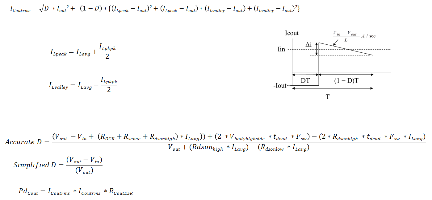

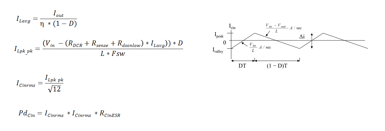

Dear all,
Could you teach us the way to calculate the power dissipation of input and output capacitor?
At data sheet, there are not these calculation.
