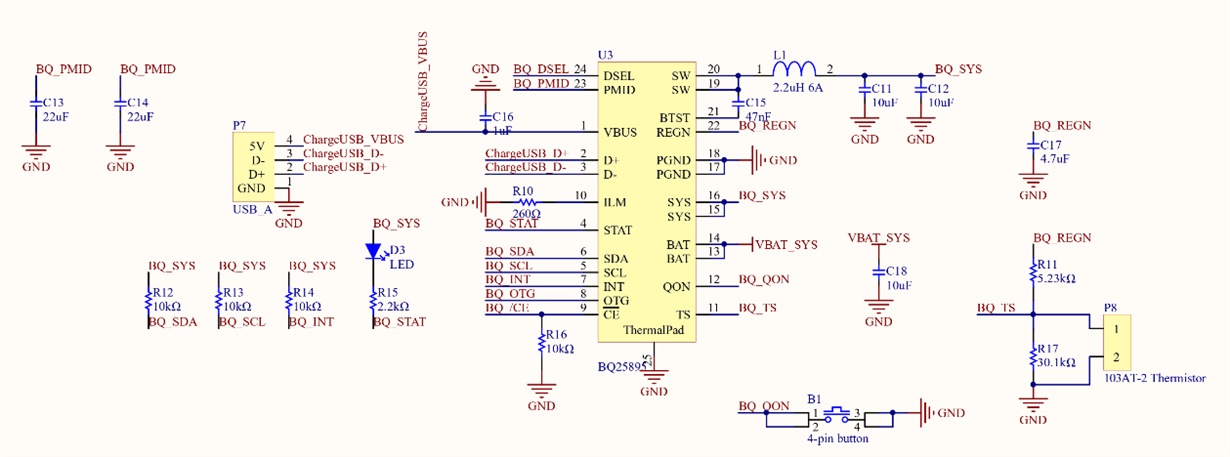

I have made a custom board with BQ25895 on it, but I encounter a charging problem with my board.
If I connect the charging port (VBUS D- D+ and GND) to an adapter with rating 5V 2A, it works okay(it draws 5V 0.45A, I expect it to draw around 2A)
However if I connect it to an adapter that support quick charge, although I can see 12V on the adapter, it automatically disable the BATFET hence there is no current drawn towards the battery.
The load on SYS is only an microcontroller which should not draw more than 30mA. The load on PMID is only a red LED with 2.2kOhm resistor in series.
Any clue would be appreciated!
Here is the registers value when it is not charging:

How can I get the maximum current out from the adapter (i.e. 5V 2A)?

    Is there a way for me to disable the D+/D- then? I just need it to be able to charge with 5V/2A. I have search through the forum, and I found that I need to short the D+/D- on my board, however I can only draw 5V/0.7A as for now. Is there any register that I need to configure in order to achieve 5V/2A?
    Below is the circuit diagram of my board if that's helpful:
  • Hello Elvin,
    Just wanted to add some additional clarification, when asking about the pull-downs on D+/D- , the intention was to make sure there wasn't something on the D+/D- lines that might affect the detection. The way D+/D- detection works is a combination of monitoring voltages and sinking currents on the D+/D- lines, so any additional impedance on those lines could cause the thresholds to assimilate those of a different USB Type, but you have already clarified this isn't the case.
    D+/D- detection cannot be disabled, but like you mentioned, you can force the detection to always result in DCP by shorting  the D+/D- lines. Having said that, it's important to understand how input current limit works in this device: the input current limit used is the smallest value between the I2C register value and the ILIM pin setting. From your schematic, it looks like the ILIM is set to ~1.5A. However, in the example of your 5V/2A adapter, the I2C register is being set to 500mA as the result from the D+/D- detection which found a SDP, hence why your input is being limited.
    You can overwrite the resulting input current limit from the detection by writing to the I2C register once the detection is done.
    Other items to verify are the following:
    • What is the charge current and battery voltage during your testing? Reason to verify this is to make sure we are in the correct phase of the charge cycle and not for example in the CV region where you won't get the full constant current value.
    • Is there a significant amount of output impedance that might force the device into the constant voltage mode earlier?
    • How long is the cable for your adapters? Too long of a cable might cause excessive voltage drop at the input of the device or inductance kicks that might trip faults.
    • Is your device heating up excessively? Would like to rule out thermal regulation. Bit REG0E[7] lets you know if thermal regulation trips.
