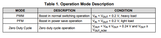

Please let me know about two points below for TPS61232;
①Operation mode
About datasheet page-11 table-1 (attached below),
If Vin: 5.1V and Vout: 5.0V, every mode are match condition.
Which operation mode PWM/PFM or Zero duty cycle for Vin: 5.1V and Vout: 5V condition?
②Internal FET spec
Is there spec for internal FET below?
・Dead time
・Rise time (tr) and fall time (tf) for Low side FET
※The reason for need above spec, I want to calculate power dissipation.
