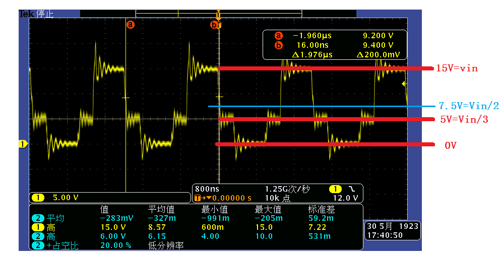

Development board transformer primary winding TP23 or TP25 waveform is 0V, Vin / 2, Vin to change. And I do the experiment board is 0V, Vin / 3, Vin to change.  I put the 5k Ohm resistors in parallel with the DS poles of the four primary MOSFETs,but  the waveform is still 0V, Vin / 3, Vin to change.

    I don't understand the second question. Especially, I don't understand how it is a device question. Can you provide some more detail? Is the UCD putting out the correct waveform to drive the power supply?

  • Hello lan Bower,
    For the second question, see the above waveform.
    The figure above is the transformer primary voltage waveform to earth, similar to UCD3138 development board No. 29 TP23 or TP25 waveform. When the input voltage is 15V, the platform voltage is about 5V instead of the ideal 7.5V.
    I am very confused. I changed the MOS, the DS side of the MOS in parallel with the same resistance, found no use.
    I tried to overload the MOS side of the DS-side parallel 10000pF capacitor, the platform voltage can reach the ideal 7.5V, but this way, the efficiency will decline.
    I want to know why the platform voltage, not the ideal Vin / 2, is the difference of the stray capacitance of the circuit board, resulting in the equivalent capacitance of the upper tube DS and the lower tube DS ?
    in addition to parallel 10000pF capacitor, are there other ways to solve the problem and not reduce efficiency?
    Thank you
