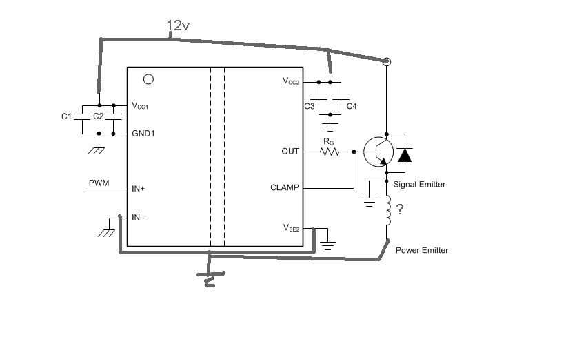

  • Thanks! Is it ok for the input and output sides to share the same 12v supply? In other words I will be defeating the isolation with VCC1 and VCC2, Ground1 and VEE2 connected respectively.
    Or will this cause problems? This schematic shows how I plan on using it.
    Also what is that inductor in the emitter path? Is it just parasitic inductance or an actual inductor/primary coil? If so does it matter that mine is above the fet between +12v and drain.
    Edit: another question, what is the max voltage allowed on the PWM "in+" pin? As the PWM IC will be putting out 12v max.
  • Hate to bump this thread but would my schematic below 100% work? The PWM in signal will also be +12v ground referenced to both rails.
  • Hi John,
    Thanks for your follow up and helpful circuit layout. Sorry not being able to reply sooner.
    You guessed it. There is no issue with defeating the isolation. Vcc1 and Vcc2 can be powered from the same supply and 12V falls in both ranges. The input logic thresholds are both the same and are dependent on Vcc1. The abs max input threshold voltage is Vcc1+0.3. So a 12V PWM signal does not leave very much headroom. (note: The inductor represents is a model for line inductance that is integral to this IGBT design).

  • Once again thanks Jeff for answering all my questions!
    How about a regular diode between the common +12v rail and UCC28C45 Vdd pin? That would give .7v more headroom and if close attention is payed to the PWM input line then any ringing could be minimized to prevent overshoot into the red zone. Its the same +12v rail so it *should* be more or less at the same potential excluding parasitics.
    Or a potential divider on the UCC28C45 output pin?
    The design does use duty cycle control to limit the current, max is 50% but does go all the way to 0% since its also doubling as a way for the user to control load power (its a bit of a specialty product). I would however be interested in seeing what your teammate has come up with as maybe I could find a way to implement it.
