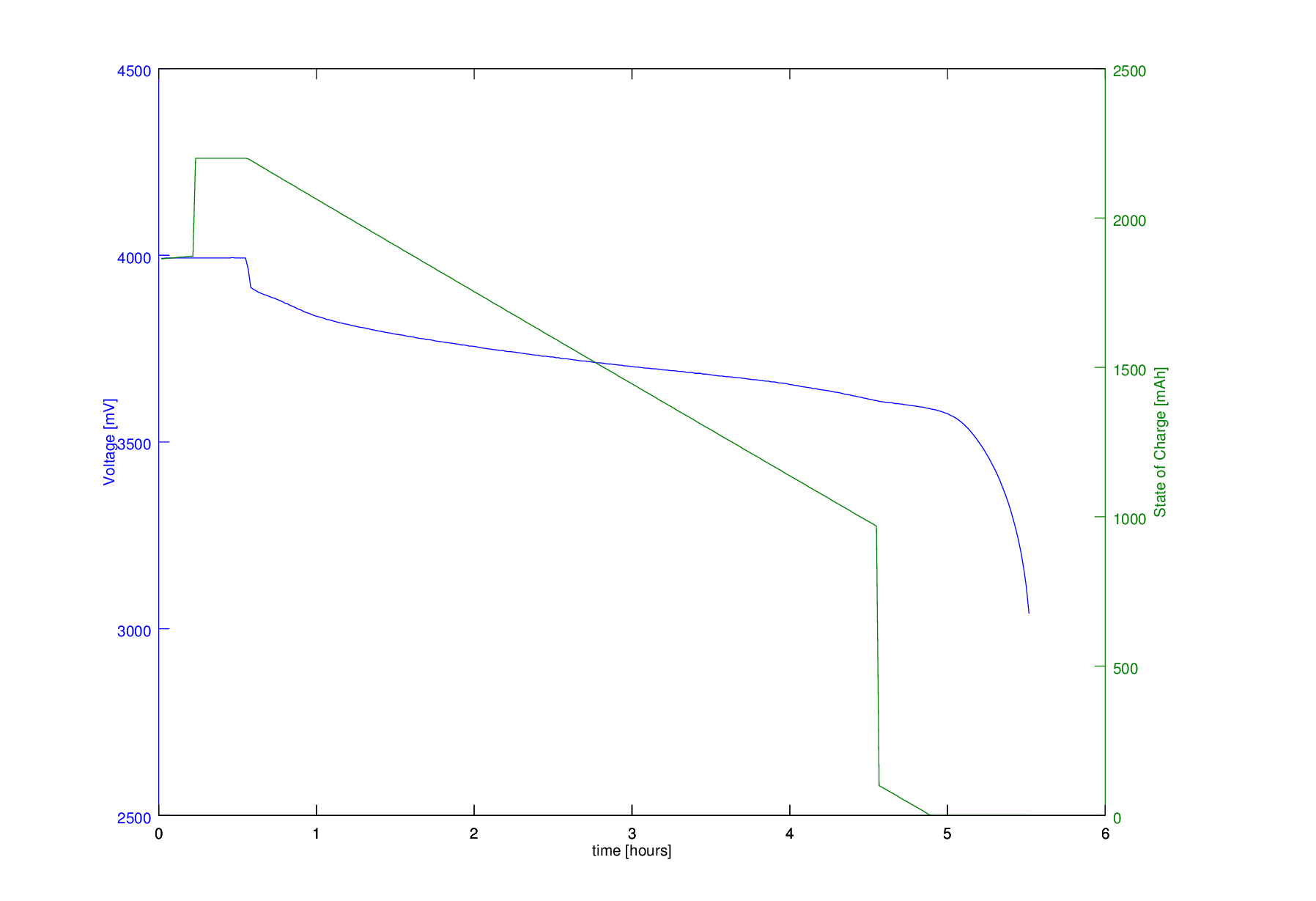

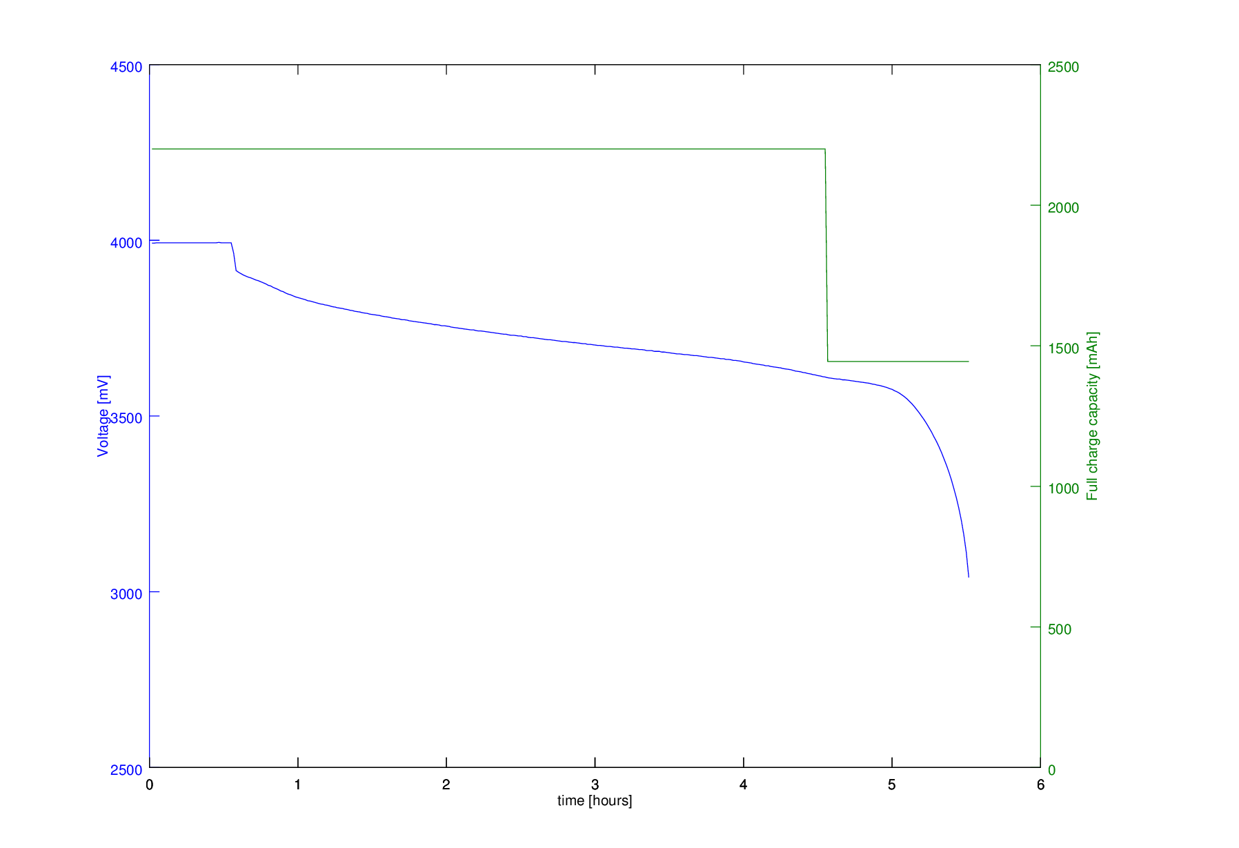

2) After setting the parameters above I performed a full discharge (qualified discharge) and logged the data. I attach the graphs. I found that Full Charge Capacity (FCC) was 2200mAh from the begining, and around EDV2 it adjusted down to 1444 mAh. I know the BQ34110 updates the battery capacity on every qualified discharge, so I expected that writing 1700 mAh into Learned Full Charge Capacity would set the initial learning state to my nominal capacity of 1700 mAh, which it didn't.

  • Hi Gustavo,
    Thank you for your patience:
    Q1. This is a good list of parameters to begin modifying. Please make sure to modify the parameters discussed in Section 2 of the device TRM. Please pay particular attention to the CEDV Parameters found in Section 2.7.9 of the TRM found at: http://www.ti.com/lit/sluubf7
    Q2. With this reserved capacity you will need to determine where the EDV2 point should sit. Normally, when using the full capacity of the battery, this point will be at 7% of state of charge (SOC).
    FCC (new) = DCR (final) = DCR (initial) + Measured Discharge to EDV2 + (FCC × Battery_Low%)
    Please find the SOC value on a graph where your device sits at your extra reserve, and EDV0 (which is normally at 0%). You will determine this by graphing your passed charge. Normalize around your new 0% value for EDV0. Find EDV1 using passed charge normalized around EDV0 where EDV1 is set at 1% of SOC. Similarly, set EDV2 at the 7% value of SOC.
    In step format:
    0. Please make sure Max Charging Voltage is set to 4000 mV.
    1. Discharge the battery to empty (terminate voltage from the datasheet).
    2. Reset your device to clear out the passed charge value and begin logging at 1 second intervals
    3. Charge to full with your 4v charger
    4. Graph pass charged vs voltage from the logs
    5. Set EDV0 to the terminate discharge voltage (this is the voltage you started at before turning on your charger)
    6. Set EDV1 to the voltage that corresponds to 1% of passed charge.
    7. Set EDV2 to the voltage that corresponds to 7% of passed charge.
    Q3. Please set Rem Cap Init Percent. More information may be found in Section 2.7.10 of the TRM.
    Q4. The end user should either charge or discharge the battery through use until RC sets. A learning cycle with be performed when the user discharges the battery from full charge. A maintenance cycle may be specified, but is by no means a requirement.
