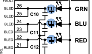

We are considering turning on/off(PWM control) between LED_cathode and G/B/RLED_terminal via MOSFET.
When checking the operation, the shorter the ON time, the larger the ILED becomes than the register set value.
Therefore, even if changing the duty ratio of the FET, the brightness that can be seen does not change.
Does the LM3435 control the LED current by ON time so that the brightness looks the same?

    We consider PWM control by inserting MOSFET as below.
    Usually I think that it controls by inputting the PWM signal to the G/B/R_CTRL pin, but we want to control at 42kHz, so we are considering this control.
    In the control of this configuration, the following measurement result was obtained.
    Is the LM3435 controlling to make the average current constant?
    ・Register setting value:35mA
    ・Measured value:
      Duty 50% -> 70mA (35mA/50% ?)
      Duty 30% -> 115mA (35mA/30% ?)
      Duty 10% -> 400mA (35mA/10% ?)
    Kato

  • Hi Kato-san,
    It is NOT recommended to add MOSFET in-series to the LEDs' connections to LM3435.
    The current is mirrored internally according to the register contents with an assumption of the load is connected.
    LM3435 might not work correctly with a series-MOSFET connection between LED and the device as the MOSFET in-series affected the control loop.
    For a 42-kHz dimming, your customer can try set the DELAY register content to minimum (~ 5 us) and drive the xCTRL pins directly with the PWM control signal.
