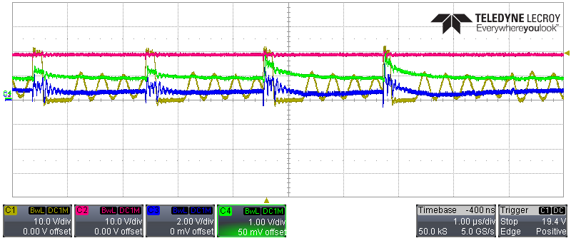

Hi!

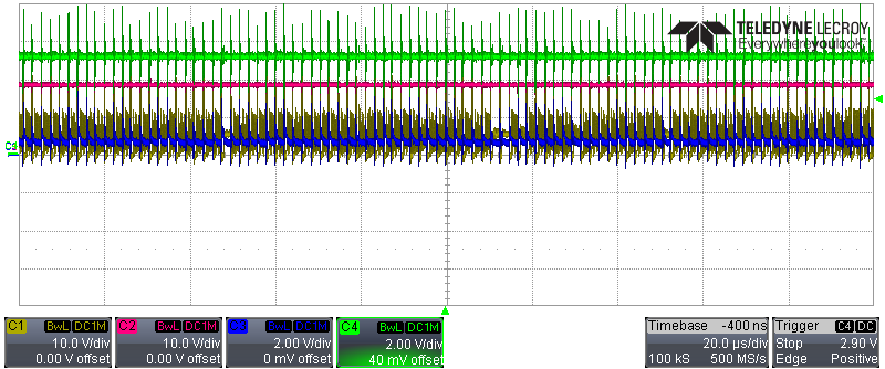

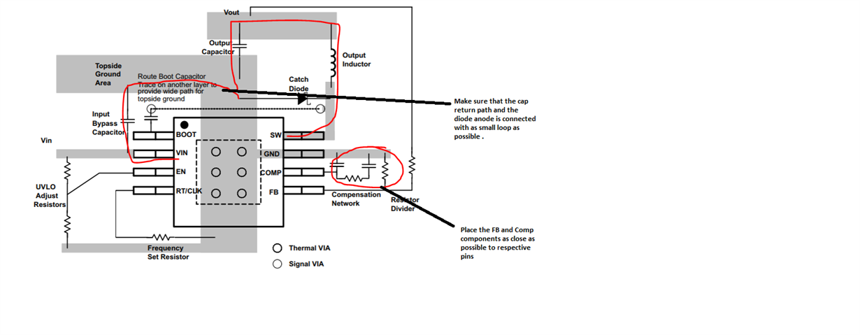

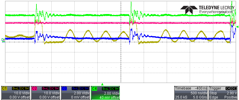

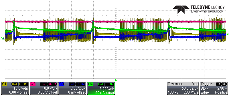

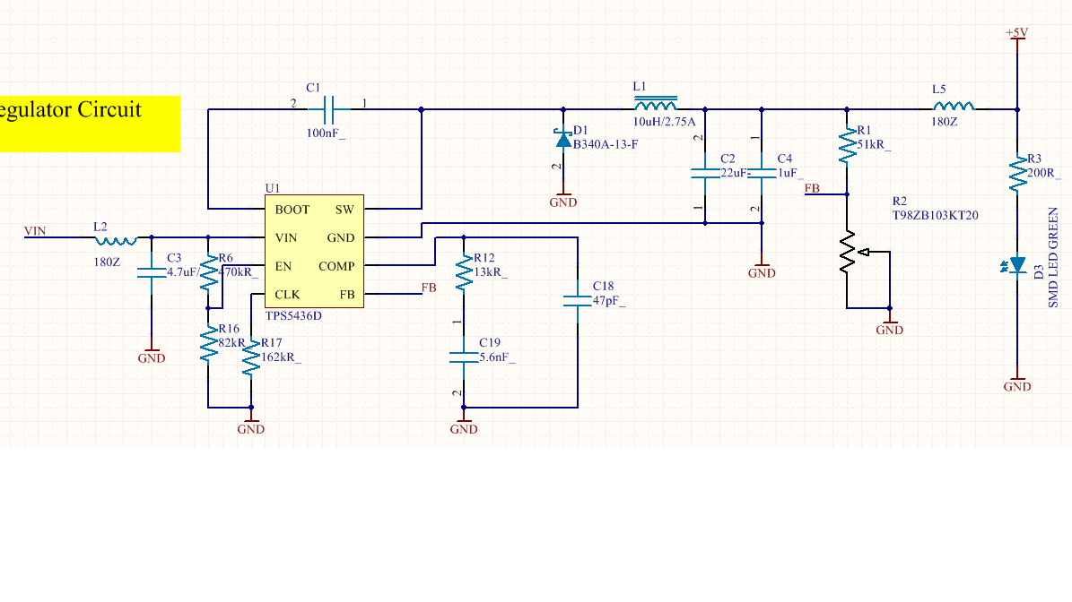

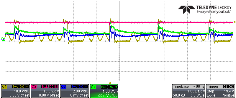

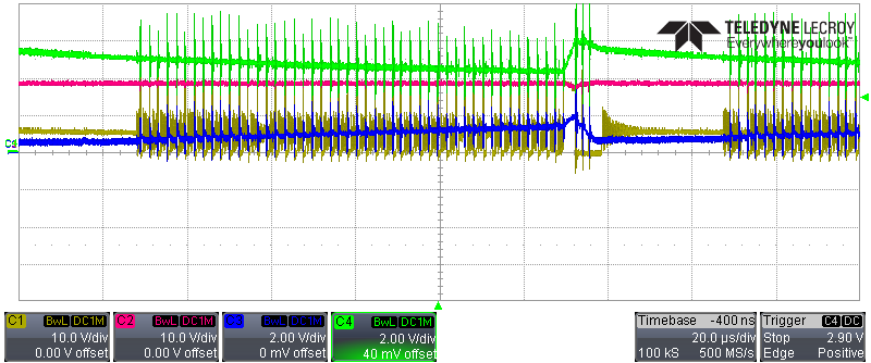

I have designed the power supply +5V using TPS54360.
The issue I am having is that resistors for regulating the output voltage R1 and R2 shown in figure below have problem. I am using a potentiometer to regulate the output voltage. At the moment R1 is 51k and R2 is 8.7K.
When i turn on the power supply and connect it to load then i hear the noise from potentiometer.
If i change the impedance then at some point I dont hear any noise but when i connect the load then again it starts making noise. Is it something related to power rating? Normally this feedback path should not consume too much current?
