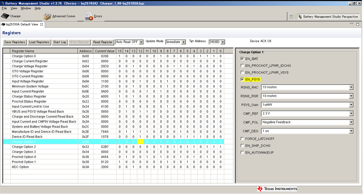

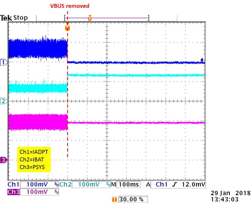

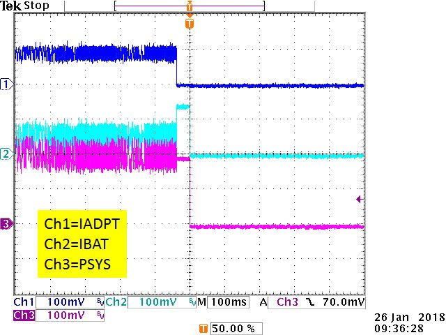

Please let me ask about IADPT, IBAT and PSYS pin output.
I can see the output from these pins when the Vbus is connected. But these output is turned off after Vbus is disconnected as attached. Do these output is active at only Vbus is connected?
180125 bq25703A 1=IADPT 2=IBAT 3=PSYS.tif
