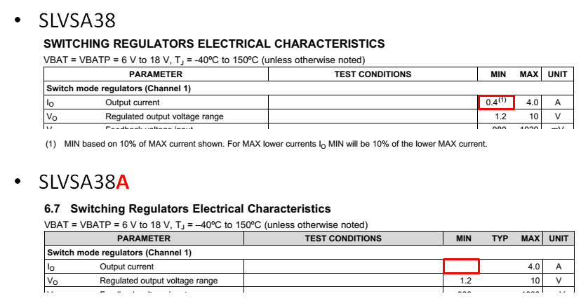

I have a customer who has used TPS43331-Q1 for their project. It seems the datasheet has been update as below.
Can you help me to address questions from customer below convince customer accepting this datasheet changes?
<Q1>: From Original to Revision. A, removing minimun output current of Ch1
What is the background of this deletion?
The minimum output current could affect to the stability of DCDC's control loop.

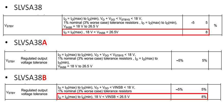

<Q2: Voltage Tolerance of Vstby>:
Removed once, but brought back again. What was that?
