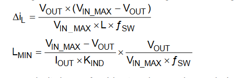

  • Use this equation as below
    Set the Kind=0.2~0.4, you can get a suitable ripple and a small L.

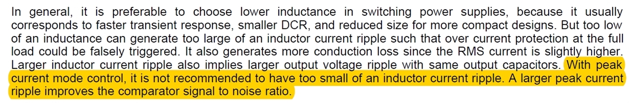

  • Hi Vental-san,
    Thank you for your support. And I am sorry for the late reply.
    I understand the minimum inductance can be calculate the above equation.
    However at the following comment on the datasheet it is mentioned about not recommend too small inductor current ripple which means the large inductor.
    My question is that there is or not the limitation of maximum inductor value.
    How much is the small of an inductor current ripple not allow?
    Koji Hamamoto
  • For max inductor, which also means the min current ripple for the detection internal.
    The max inductor will decrease the loop bandwidth and cause the device unstable.
    Normally, we want to set the current ripple is more than 0.2* Iout for detection internal in the current mode control.
