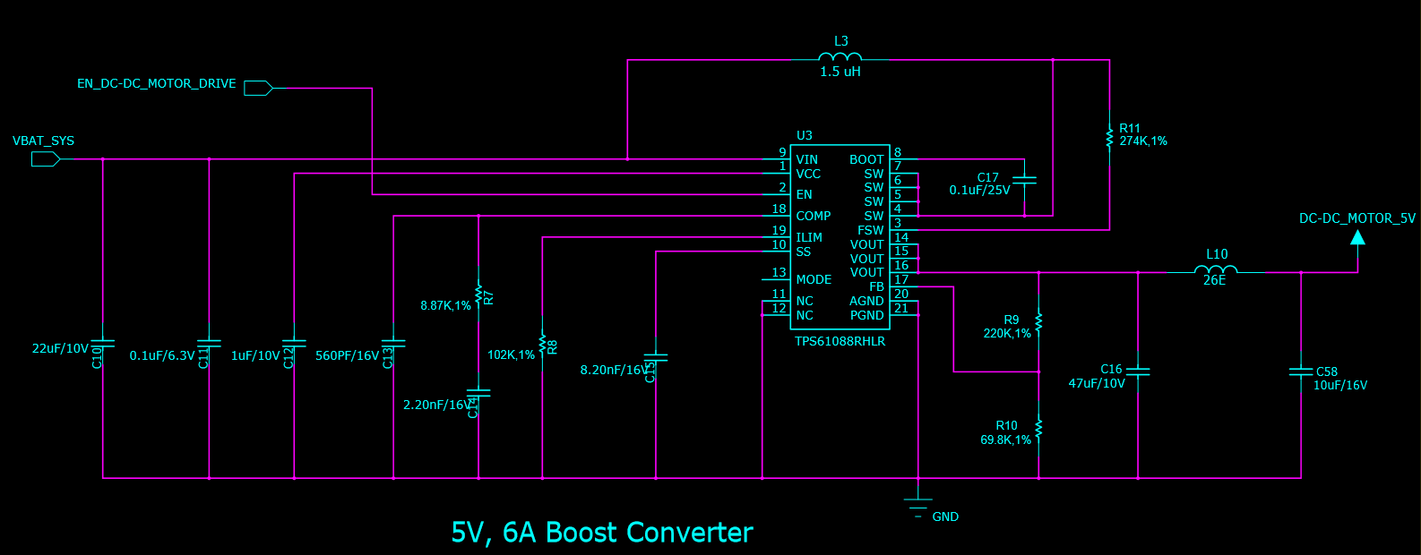

Dear Sir/Madam,
We have designed 5V/6A boost converter with TPS61088. Attaching schematic for reference. It is giving bad efficiency. For 1.5A load and 1.8A load , the efficiencies are 77% and 69% respectively. If i increase load , the results are very bad. I am giving 4.2V at input.
Please suggest if anything has missed in the schematic.
