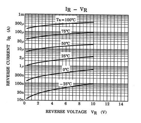

  • Hi NOBUO
    (1) case4 will be surely shutdown, but I DON'T recommend to do it. because diode's reverse current will influence FA pin current to cause frequency shift during working.
    for example this is 1SS367 diode datasheet. we can see the reverse current change a lot by temperature.
    I think case 3 is a good way.
