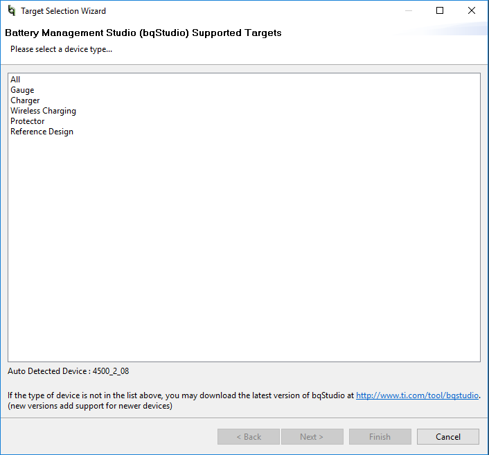

My project recently purchased a BQ40Z50EVM-561 kit and an EV2400 module interface. I'm having difficulty getting the Battery Management Studio to recognize the device correctly. Currently the Target Selection Wizard screen shows the Auto Detected Device as 4500_2_08 which does not appear in its list of supported targets. I can find no documentation on whether the kit itself ships with a BQ40Z50, a BQ40Z50-R1, or a BQ40Z50-R2 which are the three parts listed on the kit's product description page. I believe I am running the latest version of bqStudio as I downloaded it only a few days ago and the release date listed on its webpage shows July of 2017. Please advise as to how I should proceed to get the evaluation kit operating correctly under PC control.

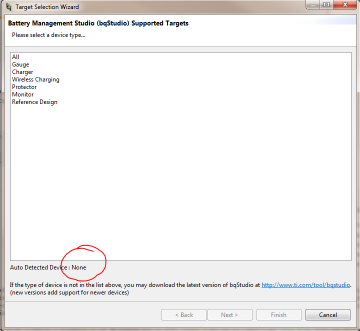

    The EVM does need to be powered to be detected by the bqStudio. There is not much point in using the bqStudio if there is nothing for it to talk to.
    If the EVM is not powered or not connected, you will get the following screen:
    The Auto detected device will be "None".
    However if the EVM is powered it will automatically detect the device.
    Are you getting a different "Auto detected Device" when you launch bqStudio?
    Can you post a screen shot if this is the case.
    Swami

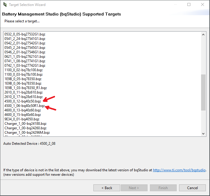

  • I get a device type of "4500_2_08" detected if I press the Wake button on the EVM (otherwise I get "None").  However, all the buttons are greyed out except "Cancel".  If I select "All Devices" from the list I can hit Next, but then I get a long list of targets, none of which match "4500_2_08".  Closest matches are "4500_0_12-bq40z50.bqz" and "4500_1_06-bq40z50R1.bqz", hence my original question of what is on the board and which (if any) of the targets I should select?

  • As I explained in both of my previous posts above, I verified that the EVM is connected to the EV2400 via the PORT 1/SMB port using the provided cable. The EVM has 3 1K resistors across the 1,2,3 ports and a jumper across the 4th port. I am supplying 10.8V from a benchtop supply across the resistor bank (1N to 3P). All the LEDs on the EV2400 are lit green for USB, COMM and VOLTEN. I pushed the wake button prior to starting bqstudio. The device does auto detect but not as anything the software seems to know what to do with, see my 2nd post and screenshots above.
  • Hi Will,
    Please download the most recent version of bqstudio. It is called BQSTUDIOTEST on the website found here: www.ti.com/.../BQSTUDIO
    It has the most up to date firmware and should fix your auto detect failure.
    Sincerely,
    Bryan Kahler
  • This did the trick. According to the software the chip is a bq40z50R2 so that would maybe explain why the older version didn't recognize it. A little frustrating, but got it solved in the end. :)
