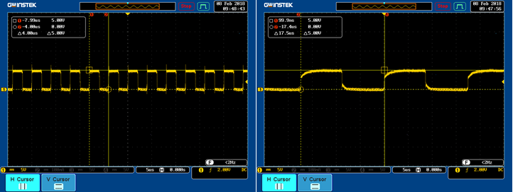

When using tps60403 in Doubler, is Cfly necessary?
When there is no Cfly, it moves by 50kHz not 250kHz.

Hi, Chris
My question is to create 2x positive output.
The schematic is similar as Fig.29, but I dont't need negative output.
So I remove Cfly, Fsw is changed to 50kHz.
When there is no Cfly, please tell me the reason that a frequency changes.
