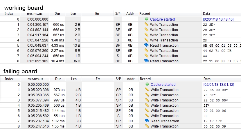

  • Update:
    I attached a bus logger to the smbus. Results are shown below:
    The "fail boards" do send an ACK bit after receiving their smbus address, so I guess that some code should be running.
    The commands in indices 4 and upwards seem reasonable to me. However I have no idea what the commands in indices 1 to 3 are intended for.
    The working boards send a NACK bit after 22 3E and the sequence stops. The "fail boards" send an ACK bit after 22 3E and the master keeps sending clock cycles and reads back his own zeros. So I'm assuming that the master is expecting a NACK after 22 3E but the "fail boards" do not behave as expected. Can you confirm?

  • Hi Sebastian,
    You're correct - the failing boards are most likely in ROM mode. With the boards connected to bqStudio, there are a few options:
    To see if there is firmware on the device, you may try pressing the 'EXECUTE FIRMWARE' button in bqStudio and repeat your test. Alternatively, you could use the advanced comm tab and send command 0x08.
    To program the device, open up bqStudio and select the firmware version and gauge that matches your SREC file. Select the execute after programming check box and program the device. It should program and boot up.
    Please let me know if these steps solve the issue.

  • Hi Bryan,
    I can't find any "execute firmware button" in bqStudio except for the checkbox below the program button. However programming the device resolves the issue. After programming the firmware anew, the calibration setup with bqproduction is detecting the boards.
    Thank you,
