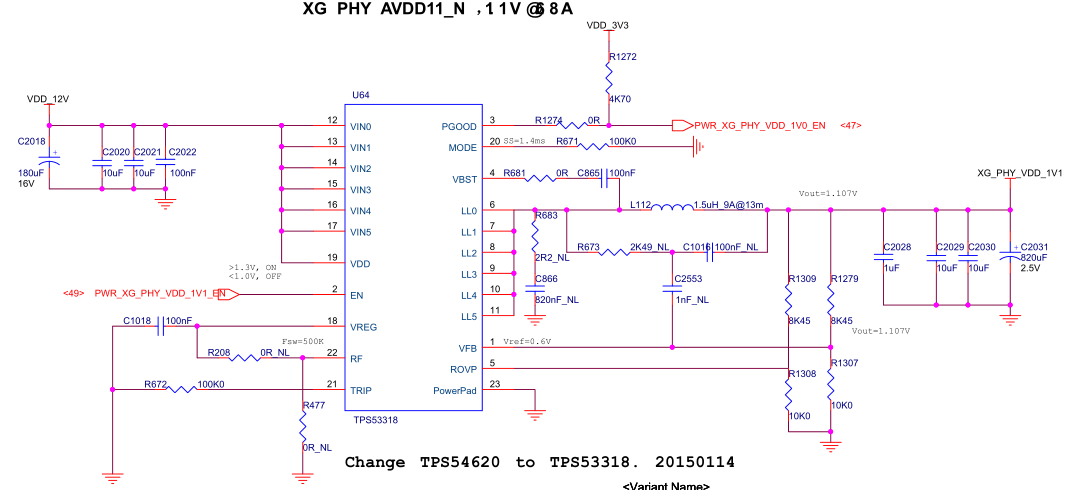

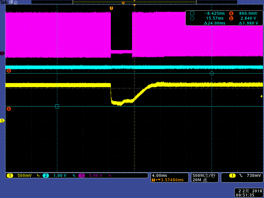

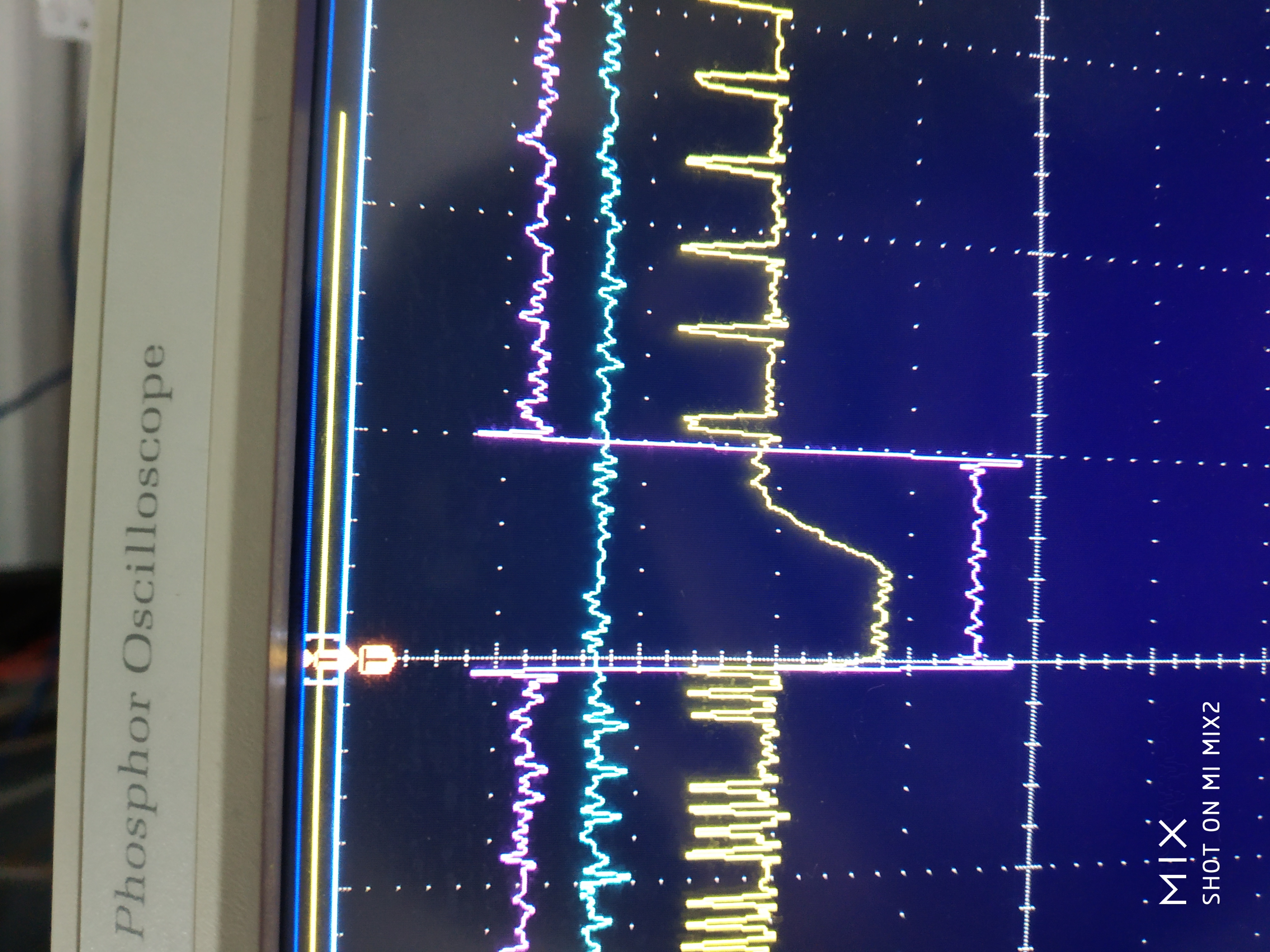

      Now I used TPS53318,In waveform,Blue is en of tps53318 ,Yellow is output ,and other is powergood.Powergood connect the EN of next power.But Load  Transient Response is not good .,especially low temperature(-10°C).Can you have some suggestion to help me.
