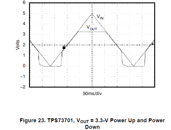

※Since this behavior can not be seen from the datasheet page 11 "Figure 23", I do not know why it will occur.

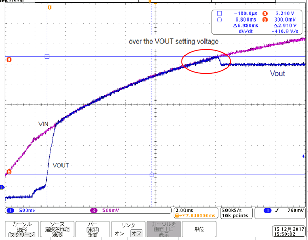

As in the following waveform, VOUT rises together with VIN and exceeds the set voltage of VOUT (for about 2 msec).
Even if the rise time of VIN is changed, the same occurs.

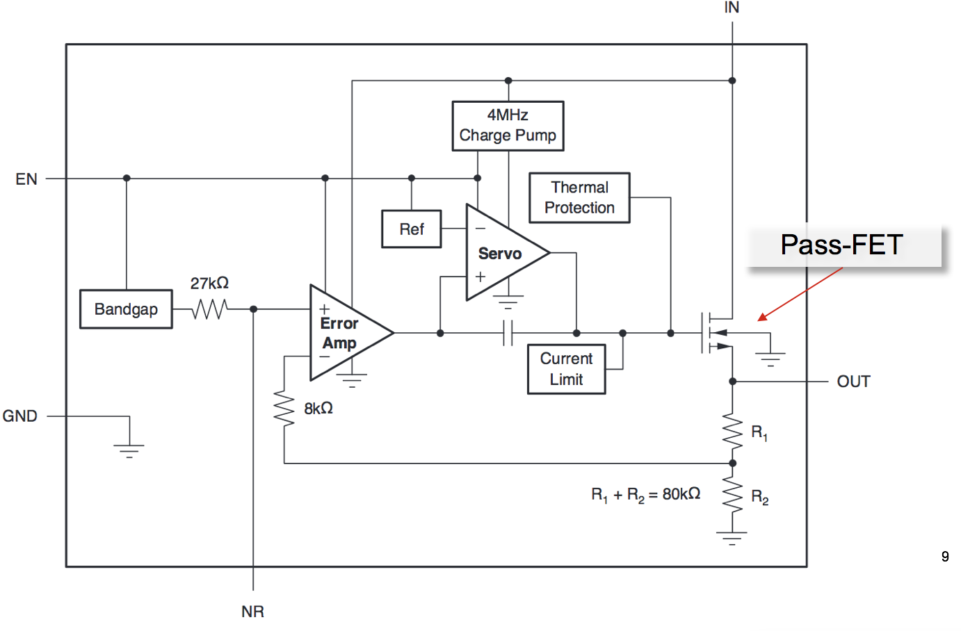

    The rise time you are using is very slow. What is happening is when VIN is ramped slowly, it is below the target regulation VOUT so the LDO will be operating like a switch, it is over-driving the gate of the pass- FET in the attempt to regulate VOUT (i.e. minimize RDSON of the FET). During this time, the Gate of the Pass-FET is likely clamped to ~6V. When VIN finally is high enough to properly regulate VOUT, Our error amplifier engages and tries to take control of the pass-FET by pulling charge off of the gate to get the Pass-FET into linear region to dynamically adjust the drop across so it can regulate the load. This control loop has some small delay which is what I believeyou are seeing.

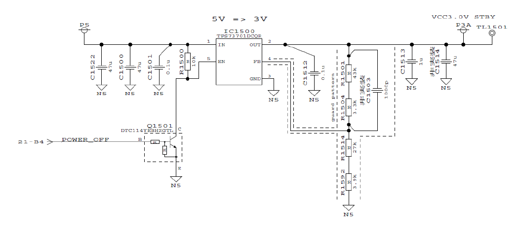

    Q3:Also, since I got the customer's circuit diagram, I also want you to confirm that there are no other factors from the viewpoint of the circuit.

    For Q3 : Adding C1503 (it does not appear to be used currently) Might help the issue you are seeing but will help to improve PSRR and transient response. It is not always easy, but following the EVM layout as closely as possible, is highly recommended.

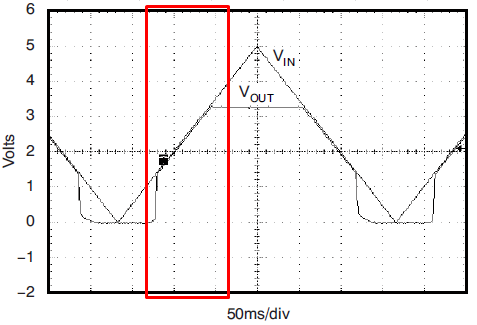

    Next, on the point that I asked 「Is not it a mistake of" very fast "?」, The waveform in Figure 23 of the data sheet is 2 msec / div for 50 msec / div.
    Comparing the behaviors at startup, I think that the customer's waveform and the red frame below are the same,
    so when comparing the time axis of this point, I felt that the customer waveform started " very fast ".
    Is my opinion wrong?
