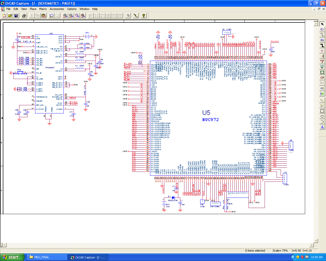

As preconfigured sequence of this PMIC (tps650701)is
1. 1.2V
2. 1.8V
3. 3.3V
If I want to change power on sequence by only Enable pins of PMIC can I do this?
I mean to say In my processor (NUC972) power on sequence I required is
1. 3.3V
2. 1.8V
3. 1.2V
so I am planning to pull up EN_DC_DC_3 so first 3.3V will on , then output will pull EN_DC_DC_2 on and this 1.8V will pull 1.2V on .
and I also want to know that if I only give power to AC OR USB OR connect battery then will all DC-DC will power on without using PB_IN and POWER_ON pin?
