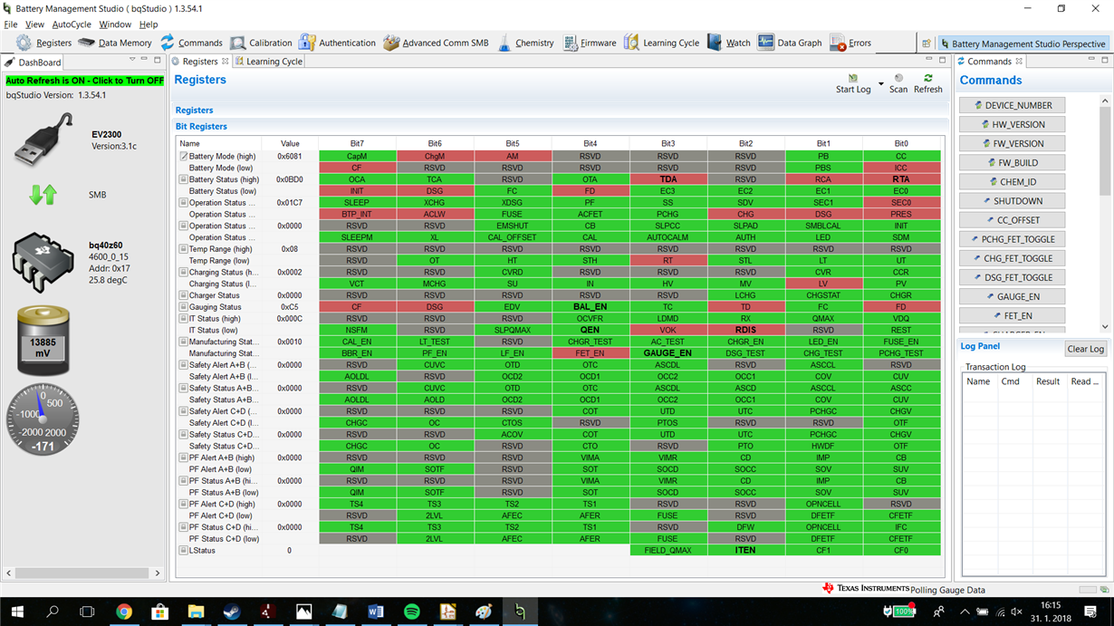

I have some problems with my custom bq40z60 board again. Now problems with charging occured.
The biggest problem is probabbly that I don't fully understand, how it should work.
I thought that, I will plug in AC adapter(I tried 20 V) and gauge will do everything for me. But it doesn't seem like that. When I plug in Adapter, it won't charge batteries.
I tried run my bq40z60 PCB without batteries, just with adapter and I measured output voltage 17,4 instead of 16,8 volts (I have 4 batteries in series - 4,2 [V] * 4 = 16,8).

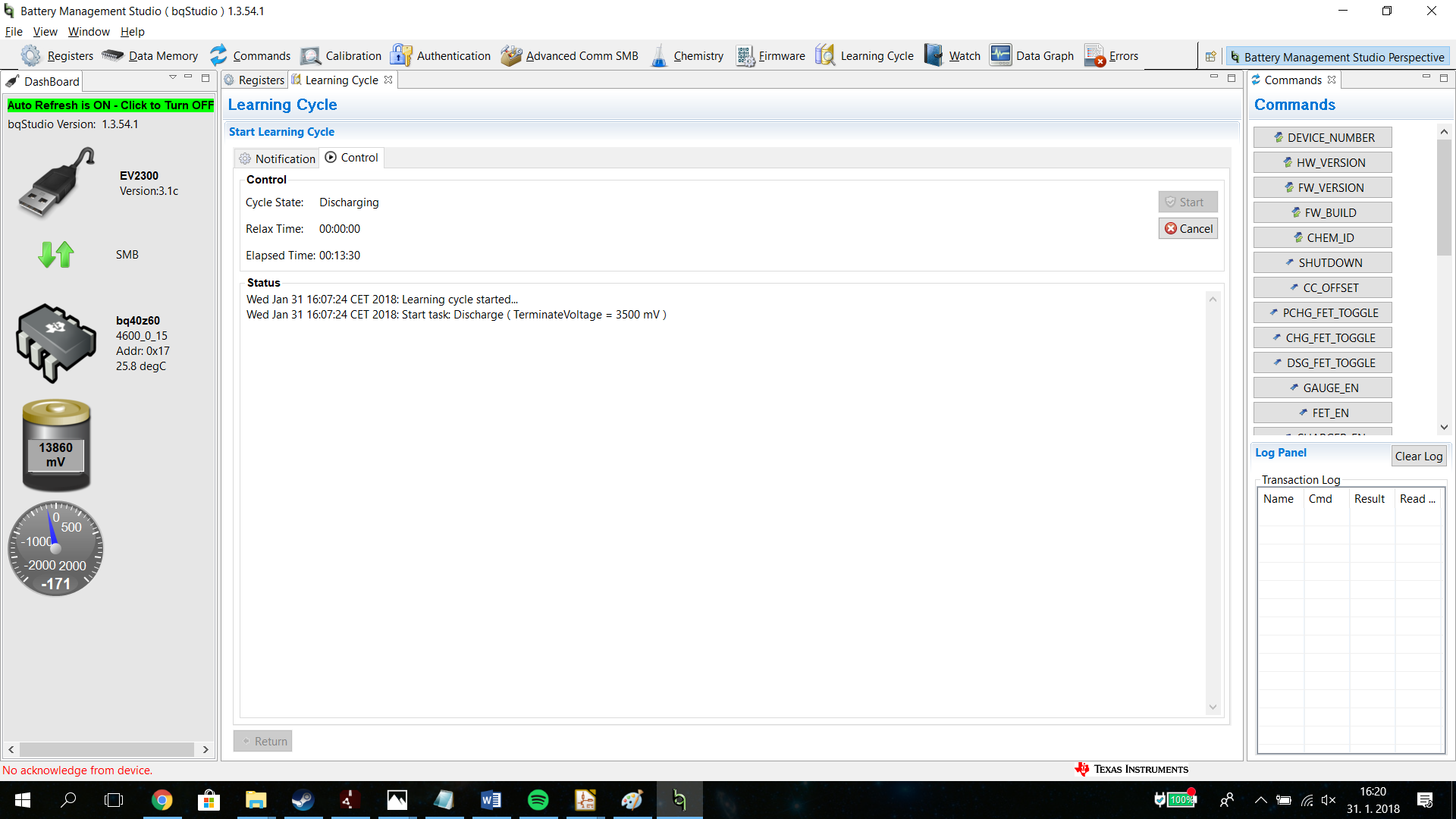

So I realized that, I have to do it through Learning cycle. But It won't stop discharging.
As it is shown in 2 pictures below, I set 3,5 V as termination voltage, but it was still discharging.

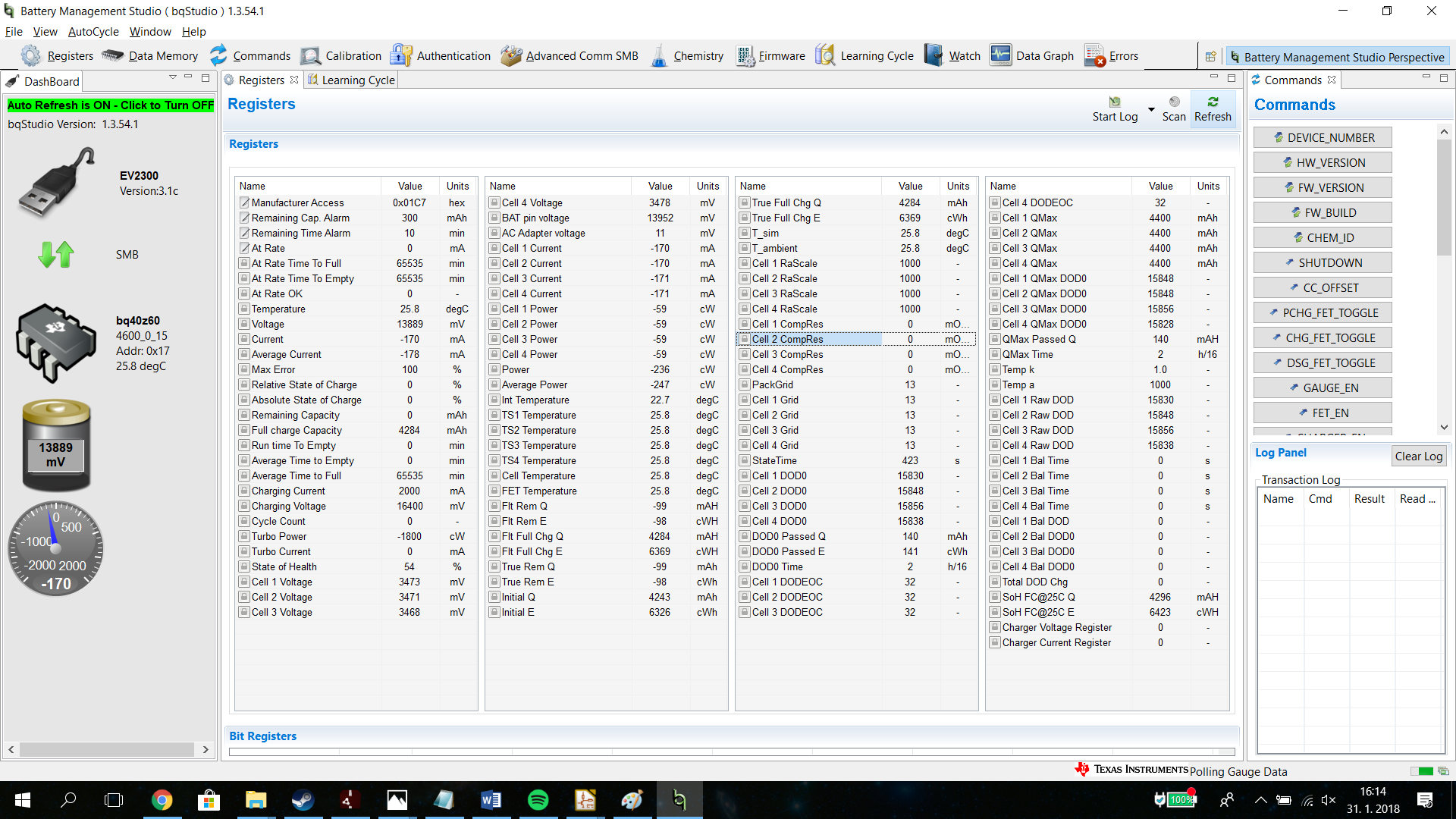

register values are attached below

1) What exactly shoud the bq40z60 do, when I plug in adapter, and what is optimal voltage? Are 20 V OK (for my 4S1P) ?
2) Is it necessary to run learning cycle for charging battery ?
2) How to run learning cycle properly, when my battery is not fully charge, and I don't want to discharge it to much

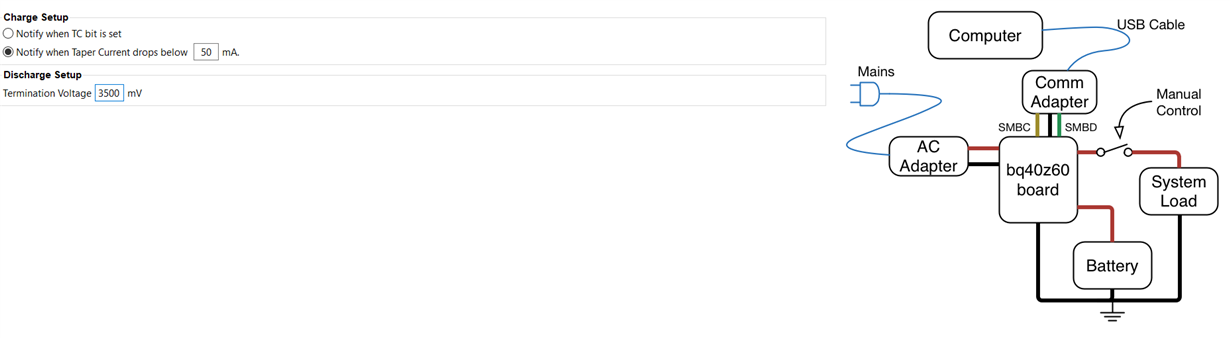

3) What does Manual option mean (instead of automatic) for learning cycle ? Does it mean, I have to disconnect Load after discharge? Because there are FETs, that can eliminate current from batteries to the load.
So, when I chose Manual, I have to be with my board and when batteries are discharged, I have to be there and disconnect load ?
And can I rely on that it stops discharging on 2.9 Volts ? Becouse as it is shown on the 2nd picture, it was still discharging, when its voltage was below set 3,5 [V]
4) Can I limit current with Max Current Register ? Or what exactly this register does?

    2A. It is necessary to run a learning cycle for the IT algorithm utilized by the gauge. Here is a great little guide for a different gauge (the process is similar): http://www.ti.com/lit/slua777
    2B. You will need to fully discharge the battery. Please refer to the instructions found with the GPCCHEM tool: http://www.ti.com/tool/gpcchem
    3. Yes, the manual option is if you don't want to use external relays to control a power supply and electronic load. Please use an electronic load set with a constant current with a terminate voltage option. On some electronic loads this will be marked by the term 'battery'. In the screenshot shown above, your bqStudio will also perform this function, but not in manual mode (as you are now the relay).
    4. If you're referring to the Advanced Charge Algorithm > Charger > Max Current Register, this register sets the current limit of the charger when the CHG FET is disabled, meaning that the battery is fully charged or charge is inhibited for some reason. For more information, please refer to Section 4.2 of the TRM found here: http://www.ti.com/lit/sluua04
