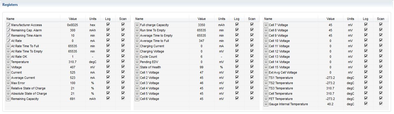

  • I think your are right. The value of the cell voltage is 400mV and the reigster value is 3500mV as you mentioned.

    I connected a array of resistor to simulate a battery pack (six 330R in series) and applied a charge voltage (24V).
    I assume the cell Volatge in the bqStudio is measured via the AFE. In bq STudio the average cell voltage is 400mV but measred with a multimeter it is 4V
    What i also noticed is that the temperature is wrong (317°, only connected TS2, TS1 has a 10k resistor, TS3 not available because i am using a BQ76930 as AFE) and also the charge current (527mA) I assume it should be (24V /(6 * 330R))

    This may be a terminology confusion, and you said you are developing you own board, but look at figure 2 of the bq76930EVM user guide www.ti.com/lit/slvu925. The resistors would be on the battery side (they are included on the EVM if selected), the left side of the board in the figure and the power supply must be across the resistors to simulate the cell voltages and properly power the bq76930. If the power supply is the charger voltage connected to the pack terminals of the system where the electronic load is shown in figure 2, the resistors may not have power. The register values you show above seem to indicate either the voltage on the resistors is very small or it is displaying an offset value. It is not clear how the part would get power if the voltages were so low. The voltage in the left column is the battery voltage or the sum of the cells. The voltage of 407 seems consistent with 9 cells at about 45mV. While it is a different product, lower cell count, and simpler function, you want your setup to look like figure 1 of www.ti.com/lit/slvuan2.

    Another concern with the registers above is your 6 cells: 24 V and 6 resistors is consistent with this. However the register display above shows 9 cells with values. Please check the AFE Cell Map and be sure only the appropriate cells are selected. As mentioned with the update voltage before you will need to get power to the part to recognize the threshold before it will allow you to change the data memory.
    The Ext Avg Cell Voltage in column 3 (shows as 0V) is measured at the BAT pin of the bq78350-R1, scaled and divided by the number of cells. This only works if the VEN is enabled in the configuration. Above it shows 0.
    The temperature is 0 by default and displays as -273.2 degrees as shown in the figure above. I'm not sure where it would get 310.7 for TS3 which is not supported in the bq76930, or where it would have found the 317 deg. It would seem the part is not powered correctly and you may have bad data. The resistor on TS1 should always give some nominal value and the TS2 should represent the temperature. Be sure to configure the temperature properly to select TS2.
    The current shown in column 1 is not the current through the simulated cell but the current in the sense resistor. Once you get the board to come on and display voltages properly, you should be able to set configuration to turn on the FETs and provide a current such as figure 17 of the bq76930EVM user guide. A few mV on SRP to simulate charge current may be needed to keep the gauge awake to correct configuration (mentioned Feb 1 above) before you are able to turn on FETs.

    I think I got myself locked out of the companion because I configured the Cell map wrong and the companion therfore measured only 400mV (46mV if the Cell is not connected)
    But how did I configure the Cell Map wrong? In the technical Reference it says 1 = Cell connected, 0 = Cell not connected and in bqStudio I assumed green means 1 and red 0. But it is the opposite. After I configuered it with red = 1 and green = 0 it worked.
