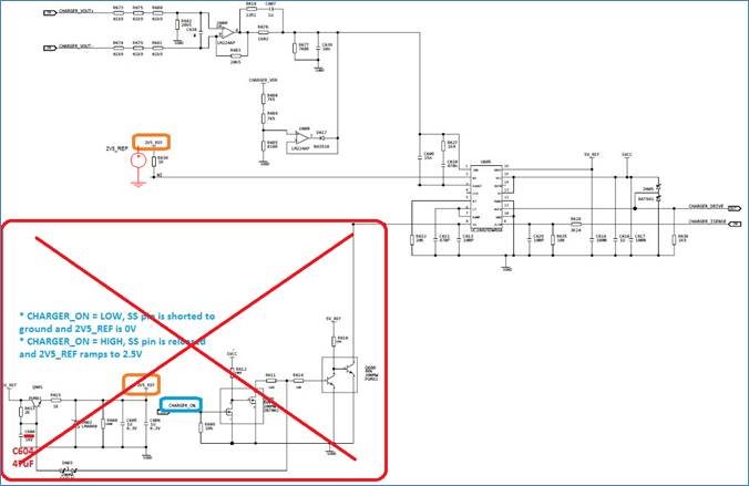

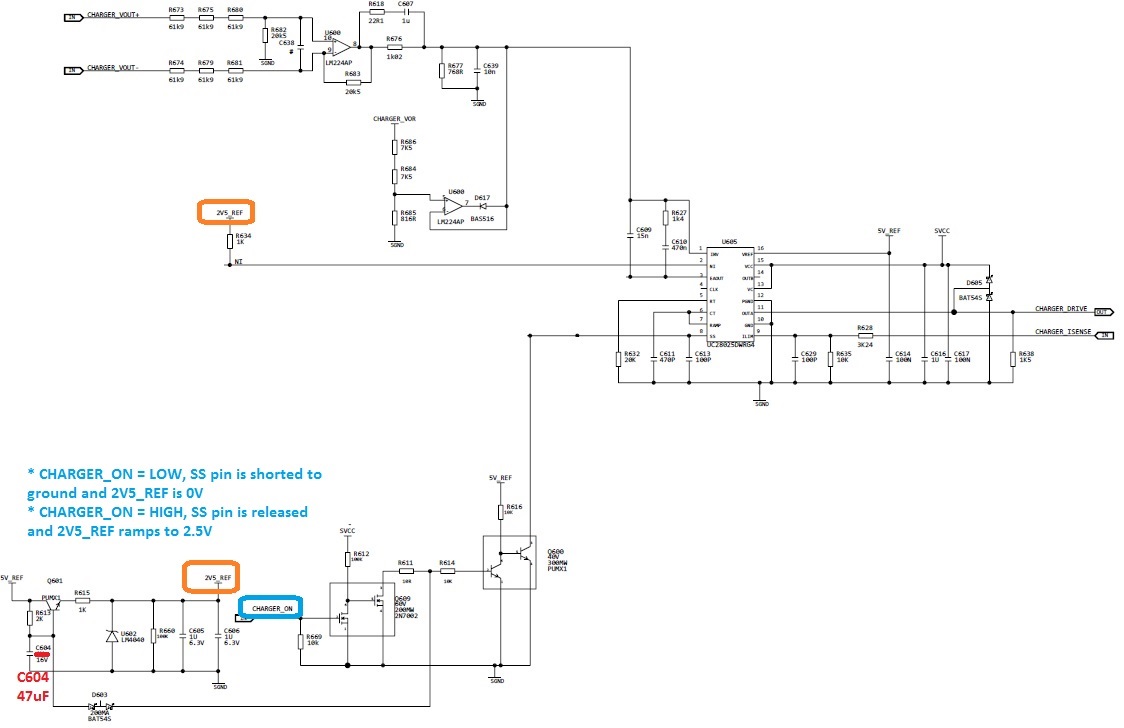

Attached is the schematic in our application.
We are using the CHARGER_ON signal to release SS pin and begin the soft start sequence. We do not seem to have trouble with this.

We are currently tuning the soft start by changing the value of C604—thereby delaying the 2.5V external reference’s rise time.
We want to delay the rise time of Vout as much as possible and to avoid having high overshoot.

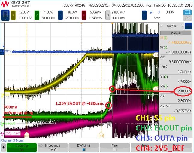

    1. Waveform 1:
    • The EAOUT pin starts at 500mV. The 1.25V level is reached 480usec before OUTA pulses start. By the time OUTA pulses start, EAOUT is already ~2.4V. Is this your expected response?
    • Based on the statement of your BU, the output of the error amplifier must be greater than 1.25V before you see any switching”, I was expecting that the OUTA pulses will start as soon as EAOUT pin is greater than 1.25V

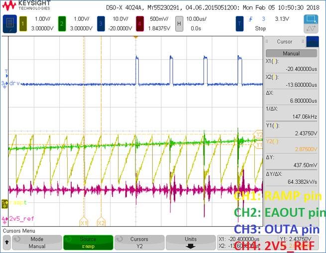

    • Time frame captures when OUTA first outputs a pulse.
    • Shows the RAMP waveform superimposed on the EAOUT waveform.
    3. Question regarding SS ramp time (refer to schematic below):
    • If the delay on the 2.5V external ref were removed and simply control the soft start using the SS pin, for a target rise time of 75msec on the output voltage, does C613 need to be around 113nF (ideally) ?
    • If not, how do we compute for required SS pin capacitance for a target 75msec rise time?

    There is an internal current source which sources a 9uA current into the soft start capacitance. The larger you make the SS cap, the slower the rise time of the SS voltage will be and the longer your startup time will be. This will adjust the delay from when power is applied to when you begin switching. The time it takes for your output voltage to rise depends on your power stage parameters such as how much output capacitance you have, if you are starting into full load, etc.
    I would suggest starting with a SS capacitance of 0.047nF and adjust the capacitance value based on the startup time you measure in the lab.

    There will be a small amount of propagation delay in the device from when EAOUT goes high to when you see the first gate pulse. There is also a delay between SS ramping up and EAOUT ramping up.
    It looks like there is an offset on the ramp signal itself. So you would see switching begin around RAMPmin + 1.25V. I don't see anything problematic in the waveforms you have shared.
