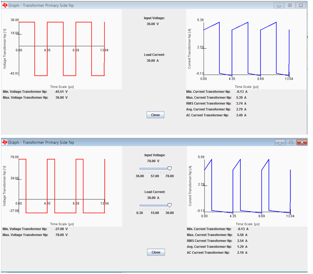

  • Hi Ben Lough,
    I have checked the input current in powerstage designer for the LM5026EVM spec from 36V to 78V input and 3.3V/30A output. The rms input current is varying from 2.54A to 3.74A from 36V to 78V for 30A. But still the EVM detecting overload at 33A output current. Could you please explain this?
    Aneesh
  • Hi Aneesh,
    Could you do me a favor and post a screenshot of your inputs in the power stage designer GUI?
    Ben Lough
  • Hi Aneesh,
    The overcurrent limit is implemented as a discrete voltage threshold on the CS pin and the max voltage on the CS pin during one switching cycle occurs at the maximum of the primary side current. Because of this, the overcurrent protection on LM5026 looks at the peak primary side current instead of the RMS primary side current.
    From the screenshots you shared, the difference between the maximum primary side current at Vinmin and Vinmax is 190mA. You will see a little variation in the overcurrent trip threshold because of this but overall the overcurrent threshold will be fairly consistent across the entire load range.
    Ben Lough
  • Hi Ben Lough,
    The over current detection scheme in LM5026EVM is based on the peak current not as per the rms current right?. If so, the explanation looks fine for me.

  • Hi Aneesh,
    Yes, the over current protection scheme is based on the peak current.
    Ben Lough
