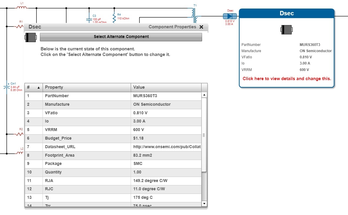

I am working on project where i'm using the ucc28911 flyback switcher.
As i was working on WEBENCH Designer i noticed that the forward voltage (VFatIo) is 0.81V (see image)  which does not match the value found on the datasheet of the product (http://www.onsemi.com/pub/Collateral/MURS320T3-D.PDF

    It seems like the parameter you are mentioning is VF at Io, in other words, forward voltage at output current. This may be a calculation result and not the datasheet parameter, and the WEBENCH algorithm is choosing the best part to fit your design needs.
    I can contact a WEBENCH developer to confirm that for you.
    Would you mind providing some information about your design, such as input and output parameters? That will help to determine how you got the result you are seeing.

    For my design parameters, I have Vin_min set to 150VAC and Vin_max to 265VAC with a frequency of 50Hz frequency. As for my output I have a 24Vdc output at 0.3A.

    That's what I thought first. I changed the out parameters of my simulation to 0.2A but I'm still getting the same values.

       The MUR360T3G should have a forward voltage of  1.25V at 3A as per the datasheet. We have updated our database to reflect this correctly. The update should be available in a few days. Thanks for pointing this out.
