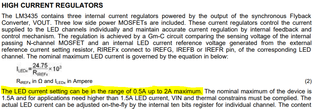

What is the reason for specifying ILED max with "HIGH CURRENT REGULATORS" on page 10 of the datasheet?
I would like to know why it is specifying the lower limit of ILED max.
Is specified to realize I2C controllable STEP?

  • Hi Kato-san,
    The planned application with the device during design stage was requiring 0.5 A to 2.0 A.
    The circuit works in CCM for the proprietary switching control scheme maintain fairly constant switching frequency as well.
    Design team from that time believed that 0.5 A is a reasonable current to keep CCM if the max current to be used in the system goes up to 2.0 A.
    I hope the above answered your question.
