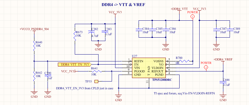

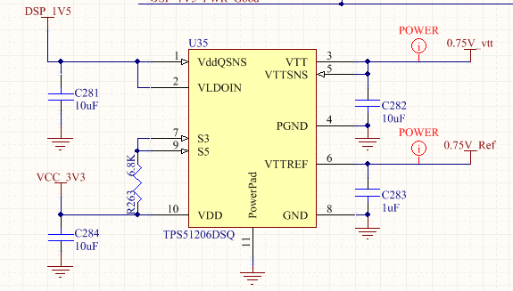

Can you help with design review for below two DDR power design:
DDR3L VTT: 0.75V_VTT connected to termination resistors (~30 resistors of 50 ohm)
DDR4 VTT: +VCCO_PSDDR4_504=1.2V, +DDR4_VTT connected to 25 resistors of 40 ohm
