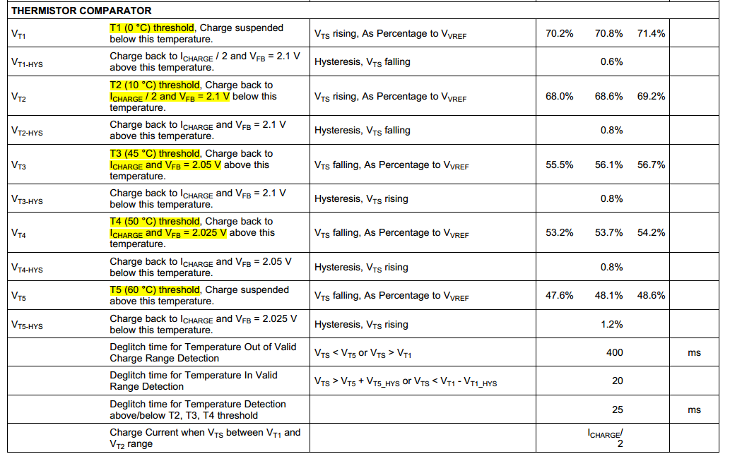

  • Hi,Steven:
          I collect my question as below.
    Suppose the charge coutput voltage is 4.2V at 10degC to 45degc,
    If the battery is 4.15V at 45degC, it will charge,right?
    continue to charge, the temperature will rise to 46degC,
    because the charger's output voltage is set to  4.1V at 46degC,
    As you mention before, the charge IC will stop charge.
    So the temperature get to down to 45degC, it will charge, right?
    As the case above, when the battery is above 4.1V,
    when charge it above 45degC, it will stop charge, right?
    even the battery voltage is above 4.05V,
    If we charge it above 50degC,
    it also will stop charge,right?
    The 0degC/10degC/45degC/50degC/60degC detect by charge just the voltage, right?
    That means if I change the RT1,RT2, the corresponding temperature value will change, right?
    If I change the charge's output voltage, for example,
    Change voltage from 4.2V to 4.1V,
    that means we will charge with 4.0V above 45degC,right?
    and will charge with 3.95V above 50degC,right?
    Thanks!
    Attached Thermistor comparator from BQ24171 spec
  • Rock Shen,
    Yes, you are correct. The TS voltage regulation corresponds to the VFB voltage (above 45C is 2.05V, above 50C is 2.025V), battery charging voltage depends on the VFB resistor divider.
    Steven
