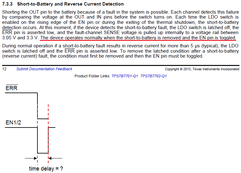

Hello team,
My customer asked urgently how much delay time is required for working properly when toggling the EN pin of TPS7B7702-Q1 as below.
Would you please guide the proper time delay of TPS7B7702-Q1 for EN pin toggling?
DY
