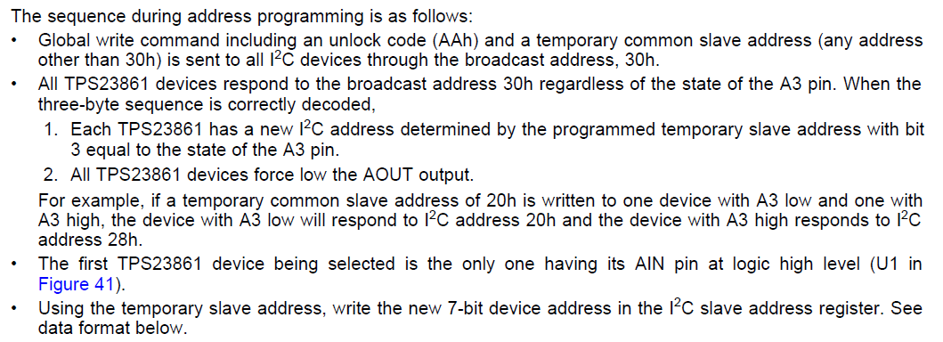

If now using TPS23861 as 8 port PSE solution:
1. How to set the address in auto mode? Do the daisy-chain connection and pull-up or pull-down the A3?
2. How to set the address in Manual mode?
  • Hi CT,
    1. When you use 2 PSE chips, please refer to the schematic below. You will use daisy-chain and A3 pin set to I2C address.
    2. In manual mode, the I2C address program is the same with auto or semi-auto mode. Please refer the datasheet description below.
