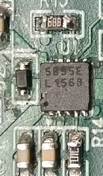

We have used LM3658 WSON package charger IC in our design. For test automation, SuperCAP needs to be charged upto 4.2V and discharge fully as a part of the test.
CHG_IN (VIN) = 5V from USB Hub
R(Iset) = 5K(500mA), USB_sel pull down 10K.
We have tested almost 200 boards with the test jig set-up, but in 7 boards, SuperCAP is charged upto 1.7 or 3V only and STAT1 = '0' & STAT2 = '1' (IC remains in charging mode). Also, we have replaced the IC and resoldered it properly but getting the same issue.
Please suggest.

    1.) Problem devices are LM3658SD-B with marking L156B.
    2.) USB_sel is configured high.

    1.) Problem devices are LM3658SD-B with marking L156B. ----> Yes. L156B marking is there.
    2.) USB_sel is configured high. ----> USB_sel is pull down with 10k.
    Que: We have produced 200 boards, and all has LM3658SD-B with marking L156B. Can you please share batch code or other information to track whether we have used damaged charger IC?

  • LM3658 IC image for your reference!
  • Hello
    There is not a batch code or damaged device issues, no know problems with the part.
    Device have three version and wanted to make sure all problem parts were the LM3658SD-B (LDO version) which is marked L156B.

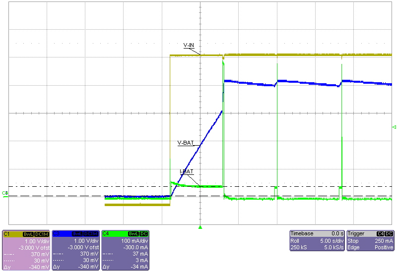

  •  Hello
    I have seen the VBAT variation between 4.0V and 4.2V, see below.  This is the capacitor voltage decreasing to recharge threshold.
  •  See below Start up into a 100mF capacitor.
    The current is limited to about 50mA for the until capacitor voltage reaches 3.0V then fast charge current is applied.
  • That's good, Issue resolved.
