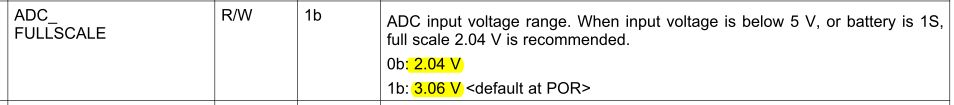

The ADC input voltage range can be set to 2.04V or 3.06V. At the case of 2cell application, what is the disadvantage when 2.04V is chosen at 2cell application?
