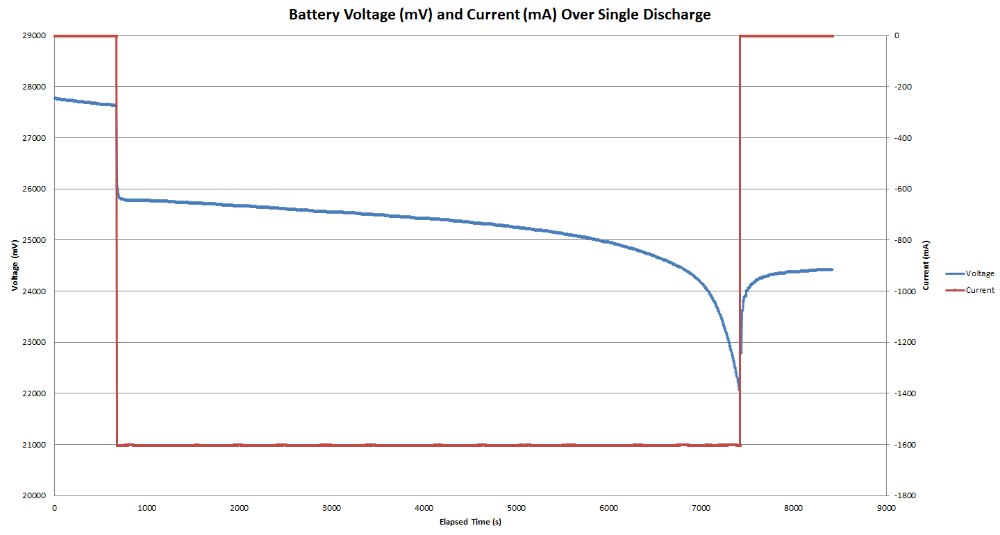

    I have taken what I believe to be a valid log for discharge at Room Temperature - High Rate.  Of course, since I can't get FC to set, I do not have an indication as to if the log was taken properly.  Would you possibly be able to tell us if this attached log is OK for what GPCCEDV is looking for?  I have the plotted data of voltage and current below, but I can't seem to attach my CSV? Sorted it out, needed to be a .log file.
    4024.roomtemp_highrate.log
    Thanks in advance

  • Kyle,
    You don't need a relax period for a cedv run.
    For using GPCCEDV please run 2 sets of dsgs at 3 temps.
    The lower rate of dsg should preferably be about half the high rate of dsg. The high rate should be slightly higher than the nominally expected rate of dsg.
    The temps should be 0, 25 and 50C preferably. Or, if you know the exact operating conditions you can fill in that temperature in the mid range.
    Trim the logs as explained in the app note and then upload them to the gpccedv tool to get your cedv coefficients.

  • The app note I'm referring to is this one,
    The Max and Min refer to the ends of the curve fitting portion that's needed for the CEDV algorithm as you reach end of dsg and terminate voltage. LearnSOC is the value of RSOC at which your FCC gets updated. This necessarily has to be higher than Min and lower than Max values.
    The app note also highlights how you have to format the values to submit your logs to the tool.
