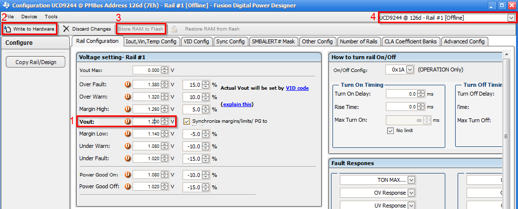

  • Phillip,
    The configuration is already inside the UCD9244 device. You can read out the existing configuration and download new configuration into the device using Fusion GUI.
    To change Vout, input a new Vout value in box 1, then click Write to Hardware button in box 2, then click Store RAM to Flash button in box 3. You can select different rails in box 4.
    If you want to save a configuration file, click File->Save Project As...
    Zhiyuan

  • Hi Phillip,
    What configuration file format do you generate for JTAG programming? If you use File->Export... to generate SVF or HEX files, the PC needs to connect to an online device to generate the files. This is because the SVF and HEX files are images of the device flash; the GUI must directly read flash content from the device. If you board cannot have direct connection to Fusion GUI, you can do so through an EVM.
    The steps are below.
    1. Connect PC to an EVM and find the online device.
    2. Download your existing configuration file into the device on EVM. Make sure 12V input is not present, so that the EVM is safe with a different configuration file.
    3. Make changes to VOUT_COMMAND.
    4. Click Write to Hardware button to confirm the changes.
    5. Click Store RAM to Flash button to save the changes into the internal flash of the device.
    6. Click File->Export... to read out the flash content from the device, stored in either svf or hex format.
    7. Download the exported file into the devices on your board.
    You can verify the exported files by downloading it back to EVM, and see if VOUT_COMMAND is correctly modified.
    Attached is a programming manual for your reference.
    If you can directly connect your board to the Fusion GUI, you can discard above steps. Simply connect the board and PC, find the devices in the Fusion GUI, make changes on VOUT_COMMAND, click Write to Hardware button and the Store RAM to Flash button, and it should work.
    BTW, VIN_MON input is for monitoring input voltage, not Vout. If you want to change output voltage feedback resistor divider ratio, you should change the resistor divider on EAP and EAN pins.
    Zhiyuan
