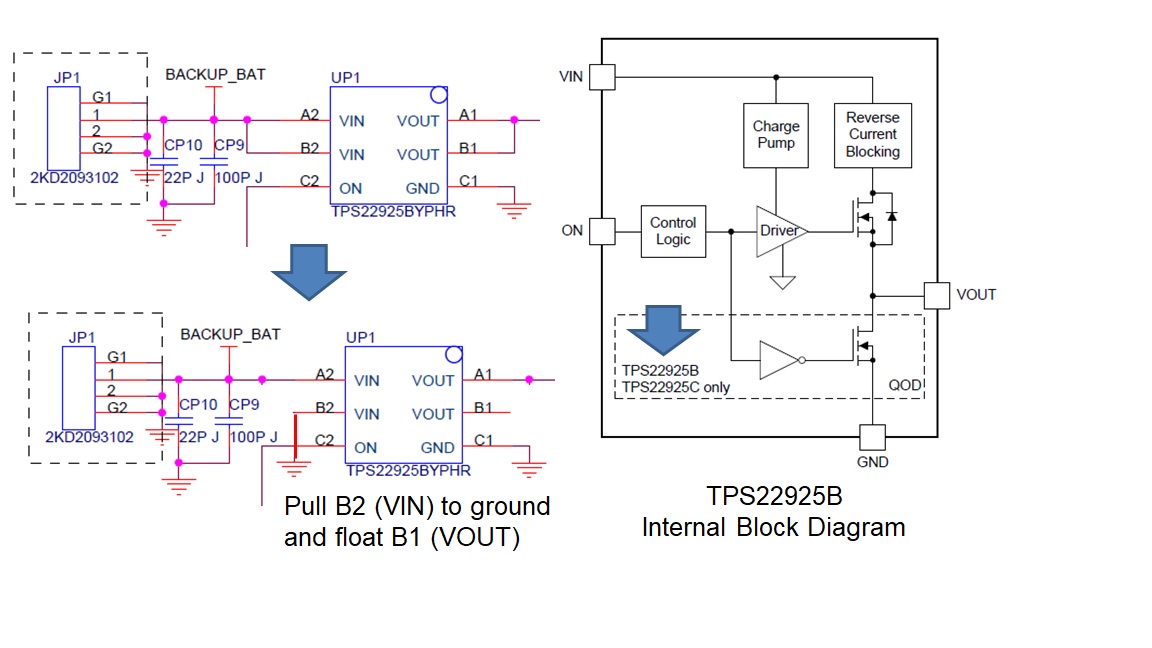

Hi Team
If pull B2 (VIN) to ground and float B1 (VOUT). Would quiescent current reduce to half?
Hi Kerr,
A2 and B2 are internally connected, so pulling B2 to ground will short your power supply. If you are looking for a low quiescent current solution, you can take a look at the TPS22916.
