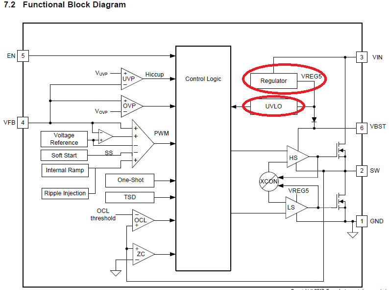

Regarding to VREG5(Regulator) on TPS565201, my customer is asking some question.
VREG5 is described in 7.2 Functional Block Diagram on datasheet(page9).
(Question)
(1)They understand that the conditions of VREG5 ON/OFF is by detecting High on EN pin.
Their understanding is correct?
(2) They understand that ULVO monitoring conditions of VREG5 is after VREG5=ON.
(3) UVLO threshold is described in 6.5 Electrical Characteristics on datasheet(page5).
(Wake up: 4.0(typ) ,Shutdown:3.6V(typ))
Is it meaning the specification of UVLO in 7.2 Functional Block Diagram?

  • 1), Yes, you are right
    2),NO, UVLO monitor the VREG before VREG5=ON
    3), I think the UVLO is relation to the Vin. Not the internal specification UVLO in 7.2. For the internal spec UVLO, it will be than Vin UVLO.

    (Question)
    (4) What purpose is VREG5 used for?
    Is it used for except VBST? (For example logic power.)
    (5)About UVLO of your previous answer: (2) UVLO monitor the VREG before VREG5=ON.
    In this case, is it meaning UVLO in 7.2 Functional Block Diagram(VREG5) ?
    Or is it meaning UVLO in 6.5 Electrical Characteristics(Vin) ?
    (6) They understood that there is each UVLO for Vin and VREG 5. (two UVLO)
    Do you have some information about UVLO for VREG5?
    For example, threshold voltage, characteristics and timing.

  • 4) the main purpose is to charge the boot cap.
    5) ans 6), I need to double check and give you reply later
  • Hi Tao,
    The block diagram is a system level simplification of the internal circuit. VREG5 is the internal 5V regulator that power the boot cap, analog and digital circuit. It is the power supply that for all the internal circuit.

  • Hi Tao
    I am Katushiro Kanao and in chargeo of same cusomer.
    1. VREG operating condtion.
    I want to conirm again for VREG operating condtion.
    You mentioned  VREG is disalbed untill EN is enable, but   EN logic needs a power for logic,
    Do  you means this IC has 2 power circuit, one is VREG, the other is power for EN ?
    2. OVP
    Thier is a OVP circuit in Block diagram.
    But there is no specification and no descripion  of OVP in datasheet.
    Does TPS565201 have OVP circuit?  If it is, why OVP is not specified in data sheet ?
    I would appredcate your suppoort.
    best regards K.Kanao
  • Hi Kanao,
    1. There should be other ultra-low power circuit supply for EN circuit first, when VERG5 is enabled, it siwtched to power supply for EN circuit as well as other analog circuit.
    2. TPS565201 has OVP circuit. When OVP happened, both HS&LS turned off.

  • Hi Vincent
    Thank you for your reply.
    Would you please reply Tao's question for UVLO ?
    This IC seems have 2 UVLO, one is VREG output( in data sheet block diagram) , the other is for VIN ( according to Mao's ansower )
  • Hi Kanao,
    5) It means in block diagram.
    6) I don't have such data on hand, either. I think it doesn't impact customer to use this device.
    Vincent Zhang
