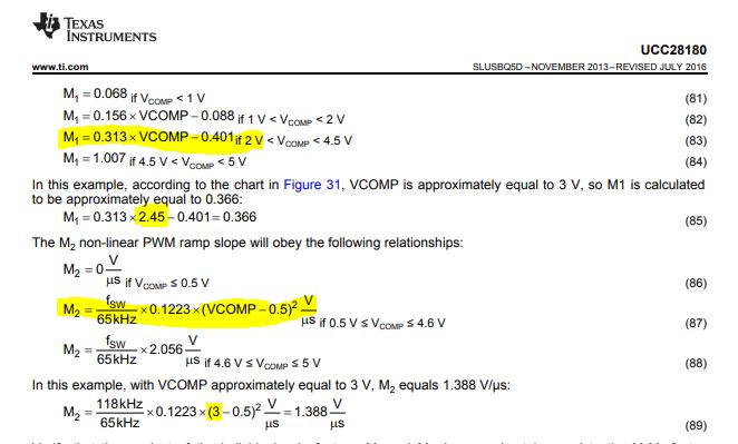

In the application note of UCC28180, why do you use VCOMP=2.45V in solving M1 but use VCOMP=3V in solving M2?
