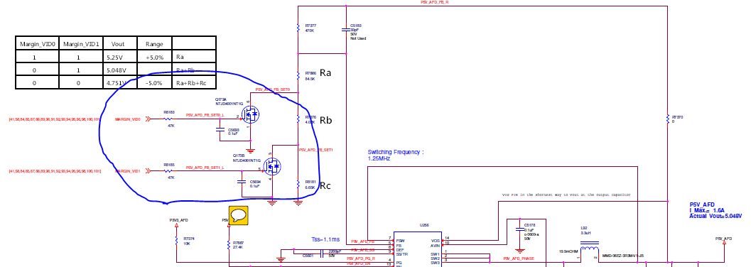

Hi there,
My customer needs to adjust the output voltage of TPS62140 on-the-fly so he adopts the circuitry as the circled area below.
I'm not quite sure if this is a common way of achieving that?
If yes, what's the purpose of the cap between the G and S terminal of the MOSFET?
Thank you!
Roy Hsu
  • Hi Roy,
    This is a customer's custom implementation per their requirements. I will loop you in on the email discussion of this.
    I can only guess that the caps are there to slow down the transition between the output voltages.
    This device also has the DEF pin, which can achieve the +5% margining easier.
