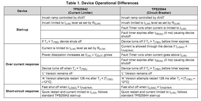

1. Seems to have Reverse voltage protection but reverse polarity is not supported. Am I right?
2. Identify the exact differences between Circuit Breaking and Current Limiting.
3. Auto Retry is not a problem with UL authentication? (I've used PTC before and it's been a problem for a certifier.)

    1A) For Reverse Polarity Protection you need to use additional diode as shown in Figure 86 of datasheet
    2A) The main difference is during over current operation. The circuit breaker device serves only for 4ms in over current condition
    3A) Both Auto-retry and latched variants are UL certified.
    4A) For latch type, the device needs i/p voltage reset or EN reset to start again.
