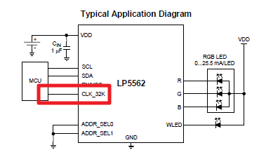

LP5562: device without external clock
Part Number: LP5562

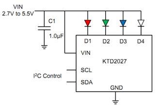

One of my custormer is using KTD2027 (attach datasheet below), but they're willing to use TI's part instead if possible.
KTD2026-7-04g - Datasheet Brief.pdf
1. usage : R/B/GW LED or KEY PAD (White) LED * 4
2. channl : 4-ch
3. I2C control
4. control each channel separately
5. current control
We promote the LP5562, but this part need external 32.76KHz CLK.
So if is there any part doen't need external clock, please let me know.

  • Hi Ts,
    If you need use one devicem you can use the internal clock directly since the external clock does not must to use.
    You can use LP5562 without external clock directly.
    Any more question please let me know, thanks!
