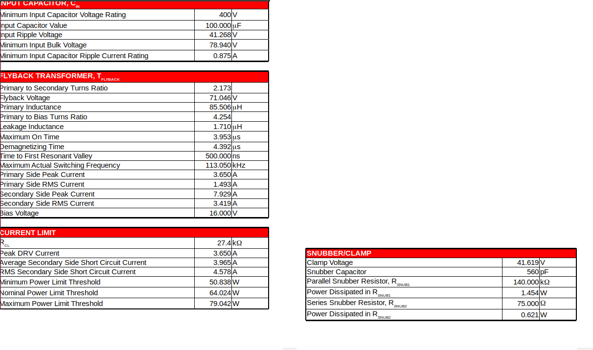

Hello there, i am using UCC28610 for constant voltage AC/DC conversion. Below are the specification
Output - 30Vdc @1.5A
Aux o/p - ~16V @ 100mA(for VDD)
I/P - 85Vac - 305Vac
Problem we are facing is-
1. Suggested Snubber(by UCC28610 design calculator) we are using gets burnt as soon as we turn on the circuit, though we still gets the output.
2. Currently PF is 0.65, Required PF is >=0.95.
3. Ithd = 109% & Vthd = 4.4%
Folks, would request you to kindly suggest the design and specification of transformer and snubber.
P.S. - please share in depth specification of transformer with all parameters required to manufacture if possible as i only have elementary knowledge of it.

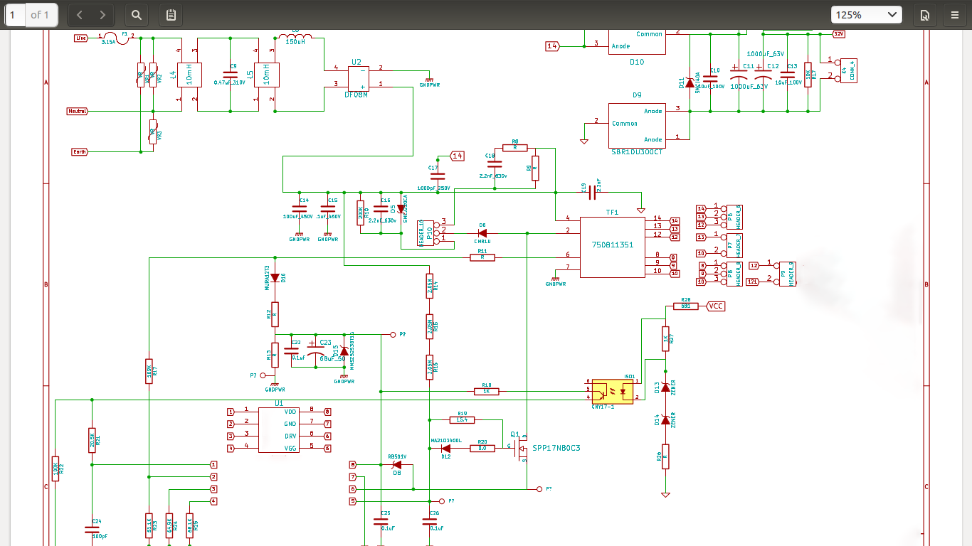

  •   Hello Sir,
    To focus on the snubber first-have you tested at lower AC input voltage to see how high the MOSFET drain voltage is ringing to?
    - by placing the the suggested snubber, Rsnub2 gets burn out as soon as i switch on, so it is not possible to take reading.
    Can you share your design details on the snubber?
    - Kindly find attachment. Here we are shorting pin 2 and 3 of p10 and RC snubber is in role.
    Have you tested the leakage inductance on your transformers?
    - Our transformer primary inductance is 183uH and leakage inductance is 40uH (tested as per your suggestion).

  • Hello Amol,
    The first thing I noticed from your reply is your leakage inductance. Typically, the leakage inductance for flyback transformers are about 2% and under of the primary magnetizing inductance. The percentage of the transformer you mentioned is about 22%, which is quitehigh.
    Because of this high leakage inductance, there will be a large energy dump from the inductor into the snubber circuit, and may be leading to the burnt resistors.

  • Hi Davit, thanks for the reply, would like to share that i have made certain inprovement in tansformer design and reached a state where snubber is not burning, but would like to know that how relaible is UCC28610 calculator; if i provide transformer specifation from that, will that be fine as there were certain value suggested for resistors which were not working as per calculator. Also, would be thankful if you can suggest how to improve PF, as it is only 0.6 as of now. thanks
  • Hey Amol,
    I'm glad that your snubber is not burning anymore!
    The calculator tools are definitely helpful, and are there to help start designs and guide users along the way on component value selection. They are not a way to guarantee operation of the device as the calculators can make some assumptions, therefore the user has to do their due diligence to ensure things are correct.
    To improve PF, a PFC device can be used like the UCC28050, a transition mode PFC controller, which can be configured as a single-stage PFC and Flyback controller with an opto-coupler feedback network: www.ti.com/.../PMP11155
